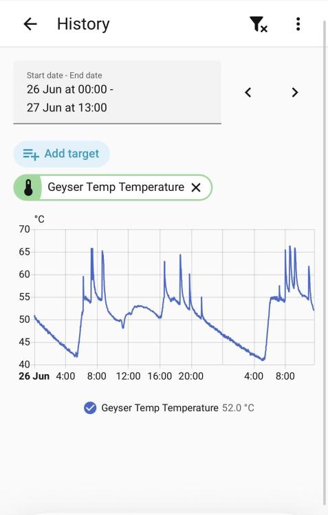

23 hours ago23 hr Author Finally all installed at the end of last week (to not much sun over the weekend). Everything has been running smoothly the past few days and service has been great from the installer - today he brought the team to move a panel as it was getting a shadow on it and not generating. I also installed Home Assistant and some smart switches on most lights, the pool and garage doors - the convenience is great. I also installed one Shelly with a temperature probe that it attached to the geyser outlet pipe - might consider a geyserwise to get a more accurate picture. Excited to start setting automations and optimizing, although I fear it’s a slippery sloop i have a spare temperature probe so if anyone has any ideas on how to get a more accurate sense of the geyser temp I am all ears!
