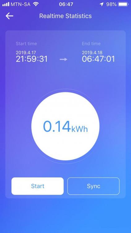

Last night I connected a sonoff pow R2 to a multi plug and had some fun measuring the appliances usage around my house. Thought i would report back here.

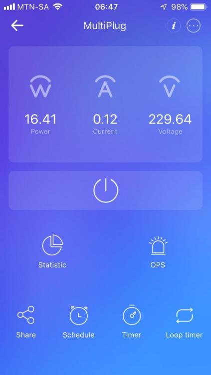

At my PC desk i have a PC, 2 x monitors, a printer (i didnt measure the ADSL router) all these things were using 16w while being plugged in, but not in use/switched on. from 17:00 to 07:00 (14 hrs) they use 0.224 KWh which is R0.48c incl vat - thats a crazy R14.40 / month by just being plugged in.

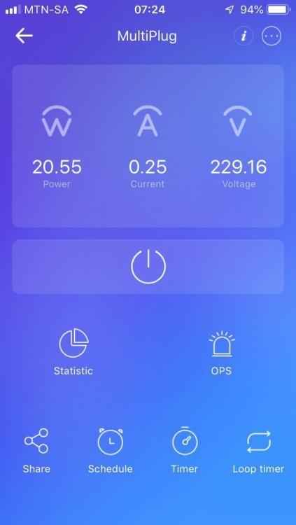

at my TV (LED tv, apple tv, DSTV, DVD player) I measured 20w, while being plugged in and not in use. again at 12 hrs through the night (we dont really watch TV) that is 0.24KWh of usage by just being plugged in. that works out at another R9.60 / month - night time usage only or 0.48KWh over 24 hrs. = R31/month.
so these cost you about R50/month by just being plugged in (not to mention all the other phantom power items - cell phone chargers, multiplug LED's, alarm system etc.) so that about R600-R700 / yr. Crazy! i had no idea i was wasting so much.
Getting back to solar - Just by switching off these things at night, I should be able to save another 5% of my battery usage through the night.
I would love to know what else I can save on or what I've missed or miscalculated. Please let me know.
