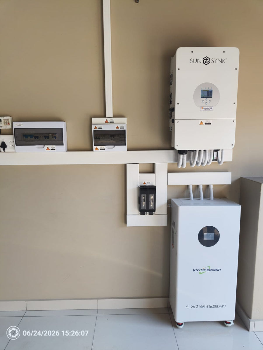

It's an interesting limitation, and I suspect that Knyee are being ultra conservative. I have 2x 16.08kWh HinaESS PowerGem Max, which is the white-labelled version of the Knyee, was also supplied by @Powerforum Store and its datasheet states 200A continuous max. discharge per unit.
