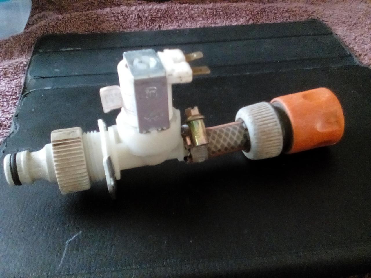

Solenoid and water Valve combo
The basic sonof switch as far as I remember switches 220v through a single pole relay, the issue is the water solenoid runs of 24v . You will have to tinker a bit more with the sonof switch or get one that has a set of contacts that don't switch through the supply voltage of 220v
