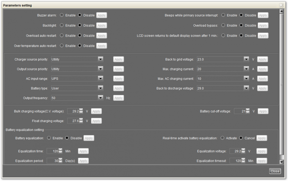

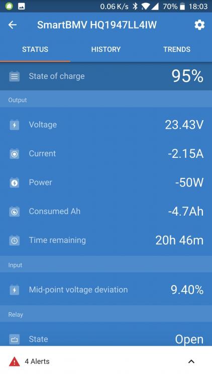

PixelZA Posted July 8, 2020 Author Share Posted July 8, 2020 (edited) Thank you very much As mentioned, I installed the BMV earlier today, then ran my PC from the inverter for about 20 minutes before the BMV started beeping, I opened the app, and it was complaining about "midpoint voltage" - said that there was a 7% difference? I then switched on mains again, the within a few seconds the Midpoint Voltage went down to 0.40% where it is still currently at. As requested, here are my current settings, but please note that this has changed so much recently since I started troubleshooting the cause of my horrible battery life... My balancer is one exactly like this: I will take some pictures of the actual installation for you as well, will have to open the battery box, its one of those steel battery boxes large enough for 2 batteries, with the inverter mounted on top, and the balancer on the side Edit: I forgot to add, the batteries have their charging requirements on the side, they read as follow: Cycle Use: 14.5 to 14.9V Standby Use: 13.5 to 13.8V Max Initial Current: 25A Edited July 8, 2020 by PixelZA Quote Link to comment Share on other sites More sharing options...

introverter Posted July 9, 2020 Share Posted July 9, 2020 (edited) I do not see any glaring issues with the current settings you posted - other than the low battery cut-off of 21V which will be safer a bit higher. Based on you use/load/charge/discharge settings the batteries appear to be treated very gently. So unless you had very different settings on the omnipowers the settings of the inverter should not have been the problem. Based on the time-frame the omnipowers very likely were in service when we had the wonderful week of reaching stage stage 6 load shedding - I guess during that week with less than optimal settings the batteries could have taken some punishment. With the omnipowers and the new batteries their initial level of charge could have been very different and you then started with an out of balance bank. Unfortunately with the high demand for batteries I will not be surprised by less than new/sub-quality batteries being pawned off as "new, never been used, kept @25 degrees in climate controlled room". Something that I do not know is whether the inverter set with the "user" battery type might cause some weird change to the charging algorithm that potentially has a negative impact on the AGM type batteries. Maybe @Coulomb would know/have a suspicion (even though this is a 24V system). Without solar not even the premature float issue seems likely. Btw, yes it is possible for one battery to have problems while the other one seems unaffected... this makes multi-battery systems bit of pain when one problematic battery can mean replacing the whole bank. Edited July 9, 2020 by introverter typo Quote Link to comment Share on other sites More sharing options...
Coulomb Posted July 9, 2020 Share Posted July 9, 2020 20 hours ago, PixelZA said: So I measured the batteries separately, the one battery was at 12.8V, the other was at 10.5V, even after standing for a few minutes with no load applied. That's about a 2 V difference; lead acid cells are nominally 2 V. So one cell of the 6-cell (nominally 12 V) battery module is almost certainly dead, zero volts. If you charge it immediately on its own, there is a small chance you could recover it, but most likely it would always be weak, probably very weak. There is also a small chance that it's just very low in state of charge (so all the cells are at close to 10.5/6 = 1.75 V), if so, charging it immediately on its own might bring it back to say 95% of original capacity. Sadly, the dead cell is the far more likely situation. Quote Link to comment Share on other sites More sharing options...
