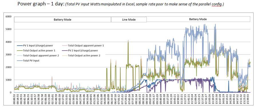

..one thing I do not have is good monitoring software! Are you using ICC on the Raspberry Pi?
My first installation (2019) is 12 x 330W Canadian Solars, the array is two parallel strings of 6 in serie each.
I have now added the second inverter with 8 x 360W Panel array all in serie to the second inverter - running in parallel with the first Axpert.
Hats of to the mppt chargers referencing different input voltages (223V DC on the one and 317V on the other), and still maintaining equal power drawn. When the load exceeds the capability of one of the PV arrays, then only will the first array ( my old set) supply more than the other - to a point where both give max for the time of day..
Just by watching the Displays and WatchPower I do not see major fluctuations (227 to 233 Vac which is 1.3%) but I will have to record the Voltages to see if I have a similar drop - that you and others have noticed.
It's difficult to comment on your graphs as one must compare them with the Voltages and also I am sure you have Battery usage and charging as well (?).
Thanks for sharing!
((PS: I see a 10% PV power increase in my old array each time I wash the panels - it's dusty in Bloem! 😅))
Thanks for sharing!
Jaco P
