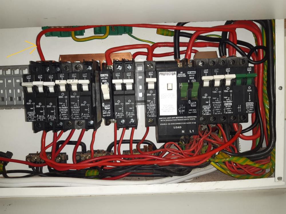

___ Posted August 25, 2020 Posted August 25, 2020 (edited) 11 minutes ago, Louisvdw said: Hmm interesting. I wonder how they got an COC for that. Oh, when I moved into this house it was the same. Note the CBI breaker to the right. If it has two green levers, it is a switch. It must have green+white combination to have overload protection. The previous owner spent over 10k to get things right, and then got CoCs for all the DBs (three of them)... and this was still overlooked. Edited August 25, 2020 by plonkster Quote
