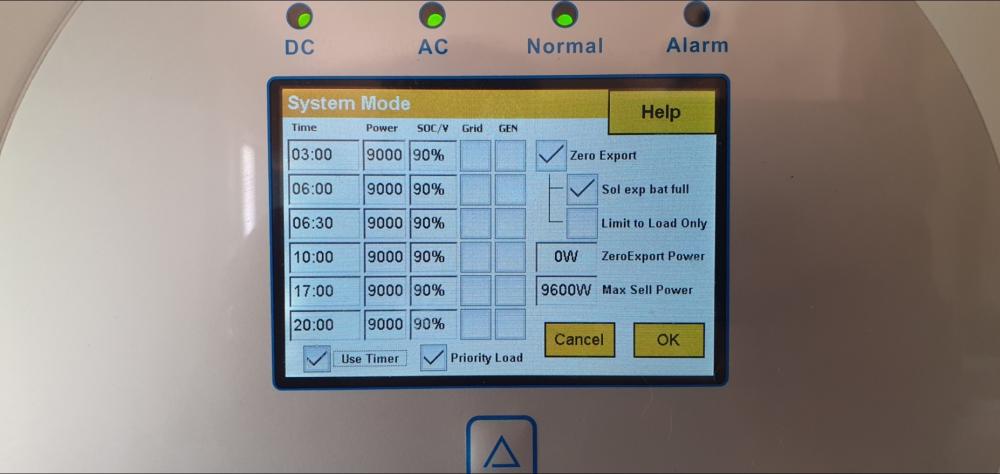

Achmat Posted December 27, 2020 Share Posted December 27, 2020 (edited) 55 minutes ago, KobusK said: Change your max sell power to the highest value. This is the power that the inverter is "selling" to the home. This is from my sunsynk. Edited December 27, 2020 by Achmat Quote Link to comment Share on other sites More sharing options...

KobusK Posted December 27, 2020 Share Posted December 27, 2020 Changed value Quote Link to comment Share on other sites More sharing options...
KobusK Posted December 27, 2020 Share Posted December 27, 2020 I have changed the max sell power and it still does not pull from the pv Quote Link to comment Share on other sites More sharing options...
KobusK Posted December 27, 2020 Share Posted December 27, 2020 Still not using the PV Quote Link to comment Share on other sites More sharing options...

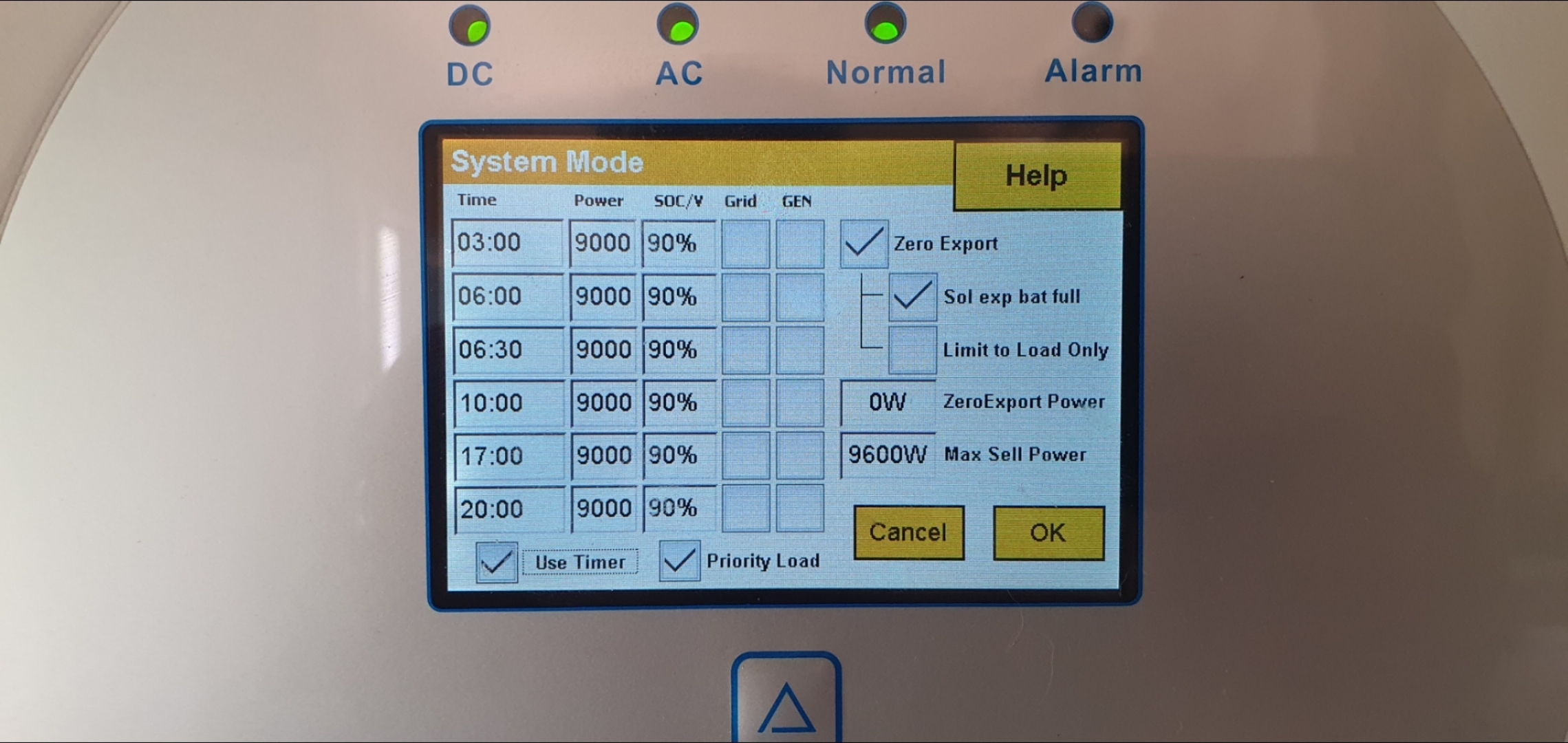

Achmat Posted December 27, 2020 Share Posted December 27, 2020 Cab you share your time off use settings. Quote Link to comment Share on other sites More sharing options...
Achmat Posted December 27, 2020 Share Posted December 27, 2020 You can also put in a small value in zero export power of 20w and see if it has an impact. Quote Link to comment Share on other sites More sharing options...
KobusK Posted December 27, 2020 Share Posted December 27, 2020 Quote Link to comment Share on other sites More sharing options...
KobusK Posted December 27, 2020 Share Posted December 27, 2020 Same problem. The only way Incan “get the PV” to work if i use solar sell. My prepaid is billing it Quote Link to comment Share on other sites More sharing options...
