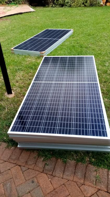

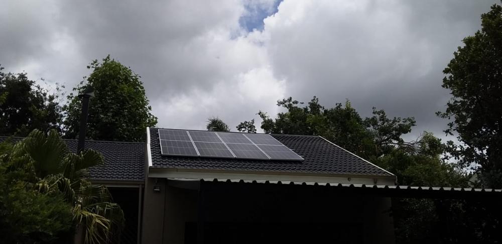

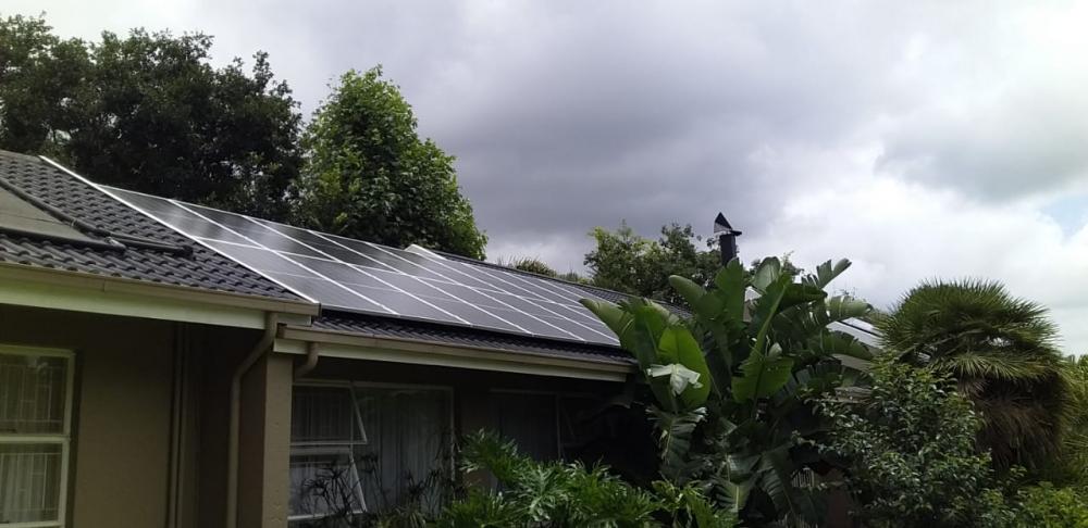

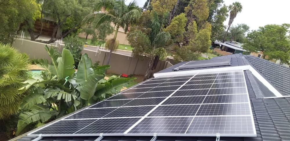

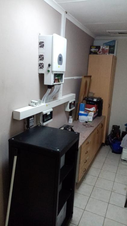

Just had my solar installed done on the 17th of Dec a few pics to follow as well
1x8kw Deye Hybrid inverter
30x400w BYD solar panels
40x1.2V 198ah Nickel-iron batteries (DIY build and super cheap)
