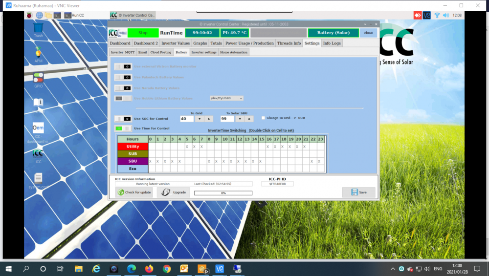

I would get pi with ICC and pylontech BMS cable (https://iccsoftware.co.za) to manage SOC of battery correctly

I will certainly look into the ICC option. Currently he is using Watchpower to check the system but I am not sure what ICC can or cant do?

Yes.Thats why I suggested ICC so that you can automate the process (setup once and than it does it by itself there after)
Automate change from utils to battery and back to utils
