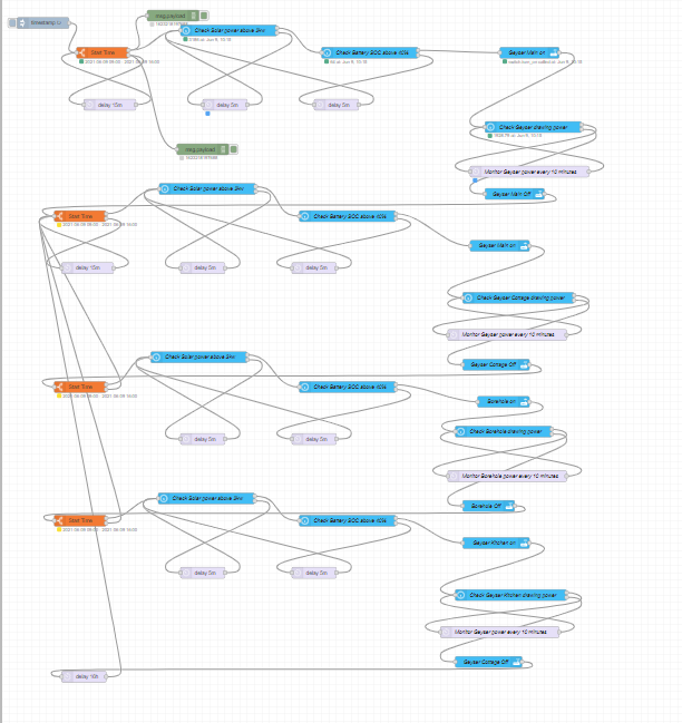

Have also been working on one to manage my geysers and run them in sequence when there is enough solar.
Seems rather complicated and I am sure that there must be a better way of doing the checks on power and battery.
flows (9).json
I prefer using the function node - easier to put things together. I've attached part of my geyser control flow - hopefully it makes sense! I'm certainly no pro-coder, most of this is figured out via many google searches!
Using function nodes you can create variables to call in other function nodes - greatly simplifying the number of functions needed. I get all my info from MQTT from a raspberry pi connected to my Kodak VMiii. You could get the info from HA just as easily though. I started with NR before HA hence my system.
