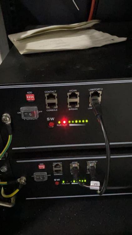

good night, I have a pylontech US3000C battery in red led alarm always on and continuous beep. does anyone know how to do a reset? or software to fix errors? Anticipated thanks
To me it looks like the top battery is supposed to be your master since you have no cable in the link port 0.
But your CAN cable is connected to the slave (bottom battery), please move the CAN cable to the top battery (the master) and see if this changes anything.
Which inverter are you using?
It looks like you are using some form of Sunsynk/Deye inverter (https://prismsolar.co.uk/product/turbo-energy-hybrid-inverter-series-5000-48/).
Make sure that you connect the communication cable from the battery to the CAN port on the inverter and that you also select the battery type to Lithium under the battery settings as well as choosing CAN as the desired communication manner.

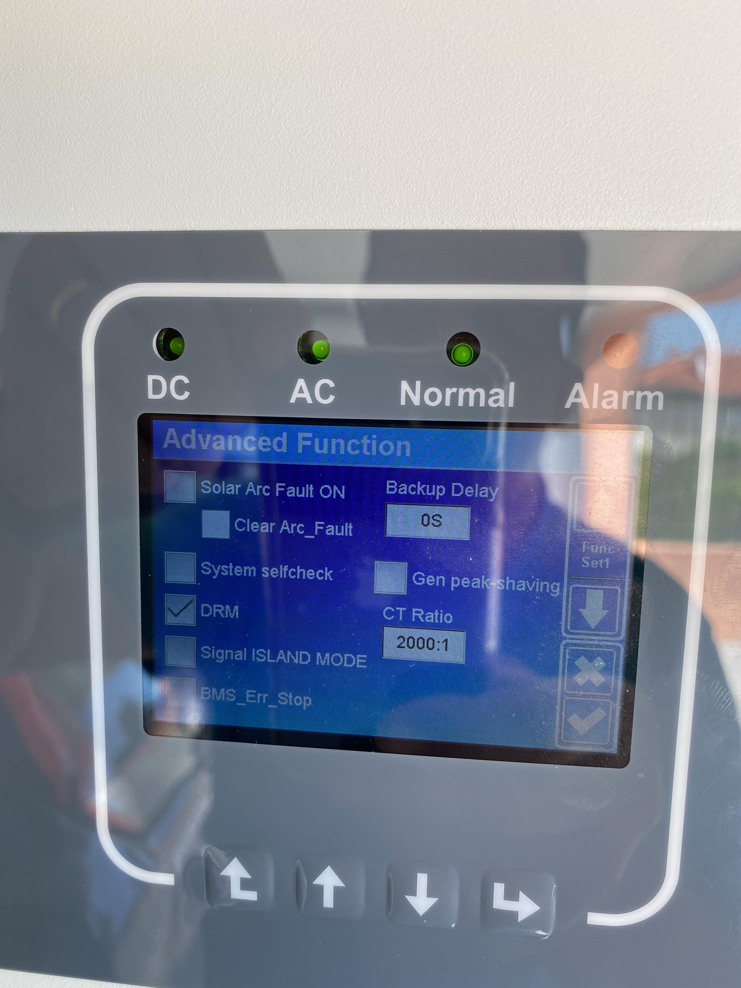

Can you post some screen shots of the inverter setting menus?
turbo Energy 5000/48
42 minutes ago, branderplank said:
Did you try and change the communication cable on the battery to see if this resolves the issue.
We need to see the battery screen menu
yes, i've tried everything, including email to pylonteh, no answer. my problem is that i only get two more from 9/15, and one that works is not enough.
I will have to send this to the supplier and wait another 2 months for delivery, I ordered the cable if it arrives before I will see if I can see the error
