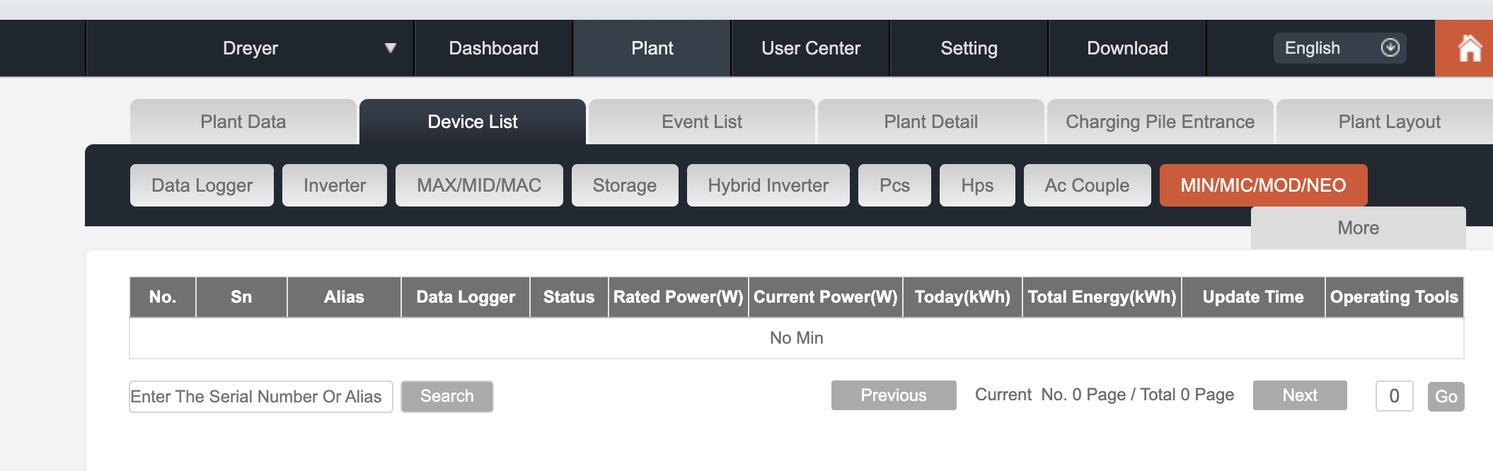

Hi @Antarya
There are no devices under the MIN/MIC/MOD/NEO option 🤷🏼‍♂️

Hi @Antarya
@L_D
What type of inverter are you using?
Depending on the model on-grid, off-grid, hybird etc you can check the following tabs
"Inverter", "MAX/MID/MAC", "Storage", "Hybrid Inverter"
Off-Grid
However, my system is connected to Eskom to load my lithium battery and seamlessly switches over when Eskom is down. I dont have PV's installed as yet. This is used to stomach load shedding currently.
Edited by L_D
50 minutes ago, L_D said:
Off-Grid
If "storage" / "Hybrid" tab is empty then I am not sure where else to find the data. Just try checking all the tabs in that page and also checkout "More" section further.
If it is on-grid usually inverter has to have a slightly higher voltage than the utility to send the power to the grid. So, if it is off grid that issue won't be there regardless the inverter AC output should be monitored (learnt the hard way).
Does the app show those data?
