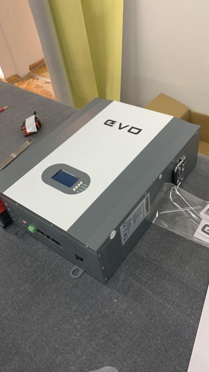

March 5, 20224 yr Author It's definitely Evo. Here's a photo of it as well as the specs EVO5.7V-1.2.pdf

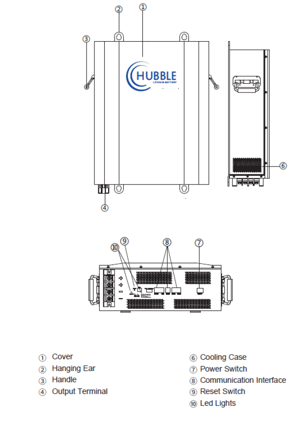

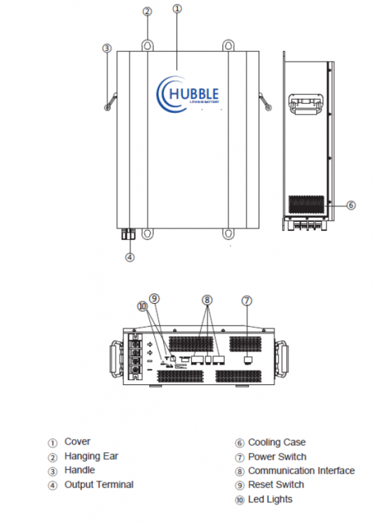

March 5, 20224 yr Nice looking battery - suspiciously similar to Hubble AM2 (see images below) However, the spec sheet seems a bit amateurish: they state elevation > 4000m. Presumably they mean < 4000m. Is the enclosure really aluminium? Looks very much like a no-name here-today-gone-tomorrow setup. No footprint on Google, no address or company details on the spec sheet. Who will you contact in 9 years for a warranty issue? I would steer clear. From Hubble AM2 manual: From EVO manual:

March 5, 20224 yr On 2022/03/02 at 3:26 PM, sjm2 said: ECO v5.7 LiFePo4 BTW given the identical box and voltages to the AM2, it is very likely that they are also 13 cell NMC rather than 15 or 16 cell LiFePo4 batteries.
March 5, 20224 yr Author Found the following battery which looks almost identical to the EVO. It seems to be a rebrand of the same battery https://www.takealot.com/lithium-ion-5-5kw-wall-mount-battery/PLID72999701
March 5, 20224 yr 8 hours ago, sjm2 said: It's definitely Evo. Here's a photo of it as well as the specs EVO5.7V-1.2.pdf 379.28 kB · 10 downloads The battery look proper, never heard of it but if the price is good, go for it and write a review. Not so long ago, some of these 1C battery brands were also unknown and they still have a long way to prove them selves too.

March 6, 20224 yr 21 hours ago, Calvin said: Nice looking battery - suspiciously similar to Hubble AM2 (see images below) However, the spec sheet seems a bit amateurish: they state elevation > 4000m. Presumably they mean < 4000m. Is the enclosure really aluminium? Looks very much like a no-name here-today-gone-tomorrow setup. No footprint on Google, no address or company details on the spec sheet. Who will you contact in 9 years for a warranty issue? I would steer clear. From Hubble AM2 manual: From EVO manual: Hubble removed the display screen and forgot to correct the numbering. they just skipped number 5 and went straight to 6
