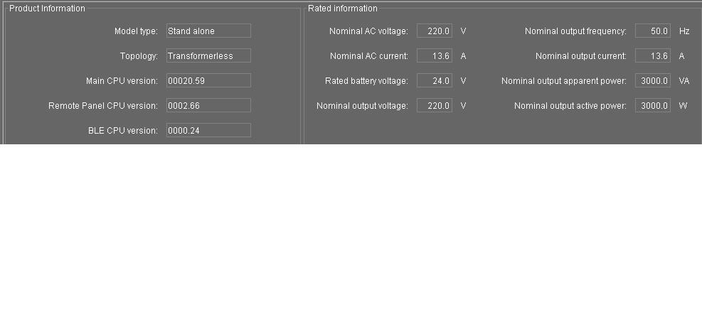

I have a RCT-AXVM3 - 3K24V Inverter.
See the attached pic of firmware Versions I have.
Are there any new firmware versions available and if so, where can I download it. I have looked everywhere but the version differ largely from what I have. Rectron don't have.

The latest main firmware file that I have is 41.17; I don't recall where I got it from. [ Edit: Duh! It was from the Czech site. ] The vm3.hex file is dated Christmas day 2020. I've just uploaded it; link below. OOPS! This is a 5 kVA firmware. It should work for 5000 and 3000 W models, as well as 5200 and 3200 W. All PF1.0.
The removable display firmware is the same as the Axpert King, so 02.66 is the latest version that I know of, and is also available from the files section of this forum.
I've never seen a Bluetooth firmware update, and I would not now how to apply it.
I have downloaded the 41.17 firmware upgrade. Flashed and now it displays ver 20.59... ???? (It looks like the MPP Solar Version. Oops....!
Anyone with the same problem. Or where can I find vers 41.14? Have to revert back to the old one...

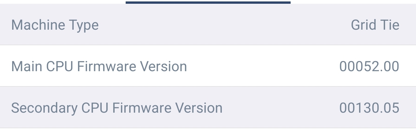

Hi regarding the firmware update for the mecer - Sol-i-ax-5m4 is there any update yet that you are aware of and if so where can I get it my inverter is giving me a very annoying issue where the solar drops to almost 0w then spikes back again to normal (read about this issue with other mecer inverters and firmware seems to solve it)
Edited by Paul7
My understanding is that the SOL-I-AX-5M4 is an Axpert MKS IV. So IF you have the '2809 processor (e.g. with firmware version 74.xx), then there is already patched firmware available for your model. If however you have the '28066 processor (probably 52.xx firmware), then there is no firmware update for that series, and therefore no patched firmware.
Hi Coulomb, thank you so much for your reply been struggling for ages with Mecer to get any information and you replied in 1 day! Attached is my inverter information can you please let me know if you know of any updates based on this.
You have main firmware version 52.00; sadly, there is no update available for download that I am aware of.
There is a slightly later display firmware version (130.06), extracted by JTAG, but that won't affect PV charging.
