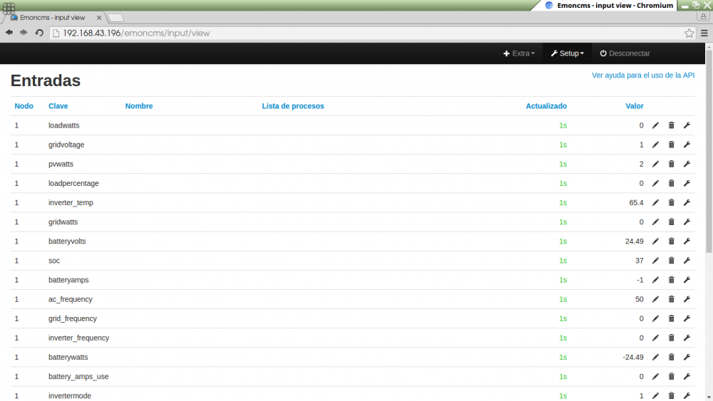

I've burned ICC image on SD card. In spite an initial error reported in other topic, ICC works and shows information from inverter.
However, when I'm trying to use emoncms site to see historical information, it doesn't show anything.  Before logging succesfully in site, I could see input data but when I modify an input process to logging to feed data, after a while, it displays a "wait..." message that let me think that something gone wrong. In order to see if there is any problem, I check a modified input process and I noticethat log to feed doesn't work, it shows an error message "Feedid does not exists or was deleted".
Attached some screenshots that could explain my problem.
Anyone with similar problem? Is there my fault? Maybe there is something I must do and I forget to do it?

The input comes directly from the reader so I would say delete the input , pvwatt , from Emon and when the reader sends the new data it should then be logged correctly. Alternatively you could also create a new user on the server and just change the key for a minute so that the data logs to the new account and confirm that the PV watt is now working on the new account then you can delete the pvwatt input and the correct data should then word. If I have to guess the pvwatt input in the sql got corrupted so you could also check in the sql if you can find the input.
Alos I noticed that you have not added any processes yet so it should look something like this when you are done:
Keep in mind that Emon local is heavily developed and not nearly as stable as the online version so you are bound to have so hiccups now and then.

I understand what PaulF007 says. Before to try your suggestion, I would explain a doubt. I could see input values on local emoncms without doing anything, just login as ICC. All inputs have been setup at ICC image, I haven't done anything and inputs get correct values. So I'm worried if I delete any input I would like to log, it won't appear. Could it happen? Could be any other explanation for this feed error?
@KIKE NICLOS I can't say for certain as I am not familiar with ICC but they way Emon works is data is sent via MQTT protocol once the data is received it is placed in the Inputs in emon. If you delete the input it will just "create" a new input once the data is received from the reader. The data you see in the inputs is not logged and is just showed as it comes in. So there should not be an issue with deleting the input but @Manie maybe you can just confirm? Worst case you might need to reset the image but again that's out of my league.

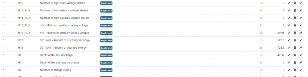

I'm afraid your suggestion haven't worked on emoncms. I've deleted default inputs and it's true that new inputs appears but result don't change. I've get same error on process list "Feedid does not exists or was deleted". At input site shows a "wait.." message according to previous pictures.
I've checked emoncms log file to have a look in case a mistake have been registed. I could see same error repeats always: "ERROR input_controller.php ! Format error, json value is not numeric". Its an odd thing because it seems input values are right but I'm not sure. I've tested information got from emoncms. maybe a json string received can't be readed so thats why I can log any input. I'm not sure if modifying input_controller.php solve the problem
Could anyone give me a clue about my problem? Attached there are different screenshots about my problem

Same error:   Format error, json value is not numeric.   All of 25 inputs have got json value numeric.  Any explanation?
I could finally fix this json error. I don't know why url string (that contains json string) sent by ICC to emoncms has a variable without value.  My solution was really simple, setting a zero to this variable.
In addition to this, I kept having problems to logging any input. The problem was redis database was enabled. Maybe this database was not properly setting and make impossible mysql to work as expected. I've disabled redis db and it works.
I'm wondering redis is job in this cms. Maybe to enable some input process but I'm not sure at all
To ensure json is right, I'll recommend to have a look to /var/log/apache2/access.log
Maybe you think input list is correct but that ICC really sends are logged at this file
There are two variables without values or format error.    invertermode hasnt got value and battery_timetominute sometimes gives 00 and sometimes gives :1    .  When it gives :1 json error is reported to log.
My case is that battery_timetominute shows : afterwards but there is no value.
If there isnt any suggestion, what I've done on php code is to detect this variable name and then set to zero.
For me is not important this value, so I fix json error.
