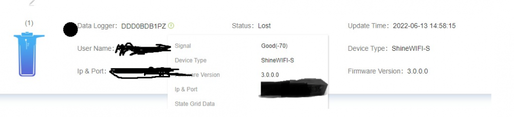

My growatt datalogger seems corrupted and I am about to give up.
I signed onto the PC App and everything seemed to work normally. Then a message popped up about an update for the Datalogger which I applied.
Then their servers went down a couple of days ago and the local Growatt Rep reckons they should be back up in a couple of days. So now they seem to be functioning normal again but my Datalogger cannot verify anymore.
i,e, It shows as the Datalogger both on the Shinefone and the online URL.
But it's status shows as lost
I have reset the logger numerous times over the last three days, yet it continues to fail with "incorrect Verification Code"
It creates the Hotspot, it then connects to my local Network, but when trying to add it to the Plant, the Barcode scan won't recognise it. I then enter the SN and CC manually and get no further .
Trying to upgrade it is also not possible as it is reported as lost.
Anyone know how to reset it so the CC code is linked to the SN again?
Good thing I have Solar Assistant to monitor my system. I have lost a weeks data already on the Growatt Logger.
