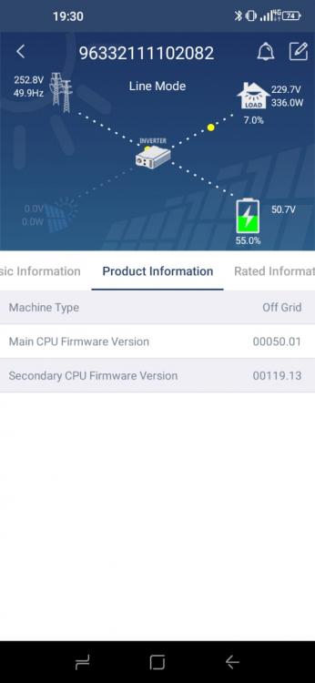

What is the main (U1) firmware version on these? Sounds to me like a firmware bug (hard to imagine), or hardware glitch (e.g. EMI getting into the parallel board cables). The latter could be really hard to fix, unless it's just clamping on a ferrite bead or the like.

Hi The firmware is 50.01.
