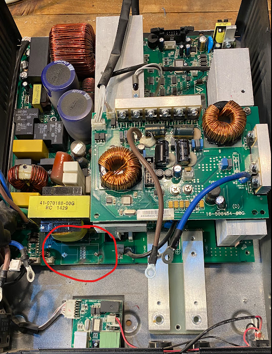

This morning when I walked into the garage I got a plastic smell from the inverter. Amazingly it was still running and powering load at the time.
Anyway, this evening I opened it up and found a fried box-shaped component in a slot marked C13 on the silk screen.  It also has two pins so presumably it's some large Cap?  I desoldered it to get a look, but unfortunately the only lettering still visible is .....AC.
Does anyone have an idea what this is and more specifically what the values are?

With a bit of luck I found the details on this forum.

Ah, that's a very useful thread.  Thanks so much for pointing me in the right direction.
For the record:
I believe that the 475K code means 4.7 μF 10% tolerance. 350 VAC means what is seems: 350 volts, alternating current.
I'm guessing that should be an X2 rated capacitor or better; it may be across the mains. Possibly killed by transients resulting from  regular load shedding.
