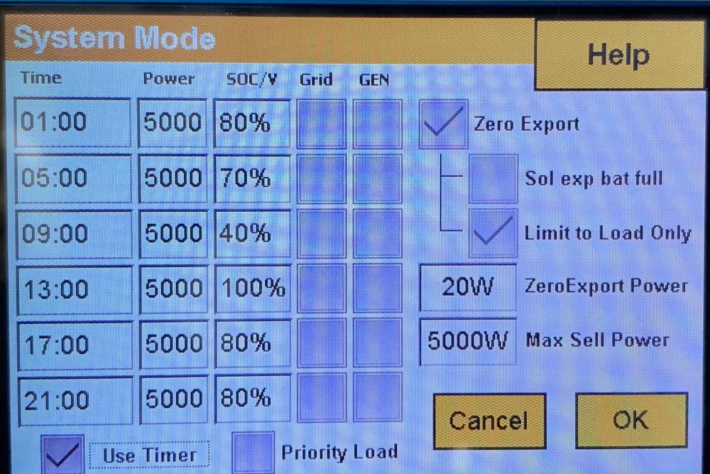

I have a new 8kw Sunsynk inverter and have some questions about the way the system "Program Charge / Discharge Times Page" works.
I have read the manual and this thread, but am still a little confused.
Using the screenshot/setup from that thread:
Questions relating to a time during the night when there is no PV being generated.
  1. What happens when the battery reaches the given SOC, does the inverter just stop supplying power?
  2. Take row 1, does it mean between 01:00 and 05:00 the battery is allowed to deplete until 80% SOC and then the inverter stops supplying power?
  3. If one had "Grid" ticked on row 1, once 80% SOC is reached, rather than cutting power would it switch to using grid power? Or does it mean that during this time, the inverter will use the grid to supply power unless the grid is not available in which case it will use battery until 80% SOC then turn off?
I'm most confused about question 3. I guess put another way, if Grid is checked, will the inverter use battery power until the battery reaches the given SOC and then switch to Grid, or will it use Grid as long as its available and if Grid is not available, will use the battery until the given SOC?
How are things different during the day when there is PV available? If you are pulling more than the PV can provide and Grid is not checked, I presume it will take the additional from the battery. If grid is checked, will it then take the additional from the Grid?
Thanks for

1. The inverter will not shutdown it will switch to taking all power from the grid as there is no PV at night.
2.yes with no blocks ticked it is set to discharge and once 80% is reached it will switch to grid.
3.Grid tick is for charging. So for example between 1am and 5am if the battery is above 80% it will use battery power until it drops to 80%.
However with grid ticked if the battery was ever below 80% at 1am it would use the grid to supply power and charge the battery back to 80%

I am thinking of just having it set to 40% SOC, no grid ticked, for all 24hours of the day and seeing how that goes. Does that sound alright?

Hi,
The export solar does not need to be ticked to feed back to non essentials as long as grid is present. as long as limit to load is unticked it can feed back to non essentials, in my case, my geyser.
I only have one large aircon on non essential, but I guess that makes sense to use the PV for that if it is available.
How much more PV do you think would be required to go fully off grid? I guess matching the 8KW of the inverter?
When a meter/monitor was installed for a week, the max load that was used was 8.8kw and we averaged 16kwh a day.
A bit off topic but I have the Sunsynk logger and app but am considering getting Solar Assistant as well. Have you got any experience with it, is it worth the money for the extra info? I do like data 😀
Thanks for the clarification.
I do have the CT coil installed and as mentioned there is only a large aircon that is not on the UPS side. So if the limit to load box is unticked, spare PV will be sent to the aircon as well, but if there is no grid, the aircon wont work? Do I have that correct?
Limit to load only is supposed to make use of the CT to prevent feedback to grid, at least that's how my Sunsynk was working... if you untick it, then it would feed to the grid as well, I believe...
If solar export is unticked then it shouldnt feed the grid. I have my geyser on the grid side with limit to load and solar export unticked.zero export ticked. As long as grid is present i can power my geyser from pv/battery. Once grid drops the non essentials immediately lose power.

Hi all,
Newbie question but similar to what's been discussed
4.5kw solar setup
2. X greenrich 3.8kwh batteries
Sunsynk 5kw inverter
As i understand it my installation has oven and geyser on non essential side. Remainder of house on essential.
During load shedding seems to be fine, charts show load pulling off pv and only batteries at night time shedding. Geyser and oven not supplied as non essential
When no load shedding however it seems the pv is keeping batteries charged at 100% and then throttling. But any load seems to be coming off the grid. Essentially PV or batteries don't supply load, either essential or non essential
I would like it to work as follows:
1.Load shedding essential only via pv and batteries - as is now
2. No load shedding - essential via pv and batteries and non essential ie geyser to be supplied by pv if sufficient available
Current battery settings
Zero export ticked
Solar export not ticked
Limit to load only not ticked
Priority load ticked
Concerned this may be due to a faulty installation
Any advice would be much appreciated.
