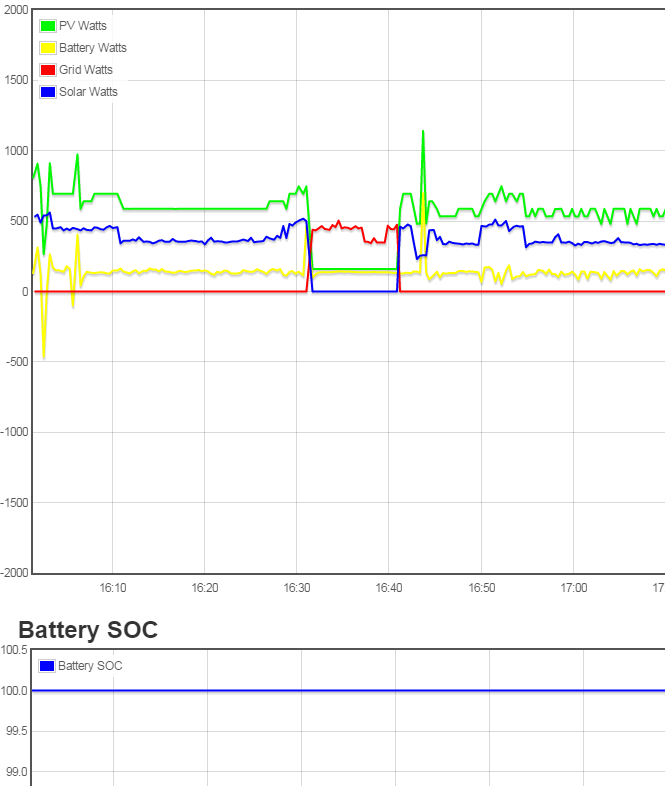

Saturday I finally got the house connected back to the solar. Only one inverter at this stage, as I'm waiting on some new cable.
Everything is running great, except for a few hiccups on the monitoring side of things.
I'm pretty sure it's related to the Serial-to-USB converter drivers, but it seems to take about 15 minutes before AICC can properly see the inverter.
I tried installing AICC with all the drivers etc onto a Windows 10 netbook, but it kept crashing within seconds of me pressing start, so I gave that up and went back to the Windows Vista laptop.

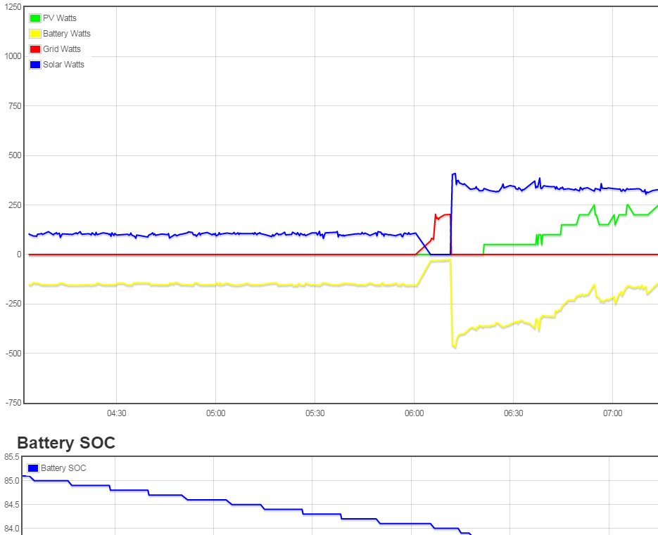

One thing though, and perhaps JDP has a solution. For the time being I've kept the BMV settings in the software at the pre-set values, but come 16:30 in the afternoon the software sends the signal to the inverter to switch to grid mode, and it does so...for all of a few minutes, then switches back to SBU. Any idea what I can change in the inverter or even AICC settings so it doesn't switch back on its own accord?
At first I thought it might have been because the batteries were fully charged, so last night I set the software so switch to grid at 06:00 when the batteries are at their lowest SOC, and the same thing happened
56f0e912c8224_Inverter1630.thumb.png.0d3
56f0e90e4aaf8_Inverter0600.thumb.png.7d9
Post your settings page without your account details of AICC and Watchpower.
