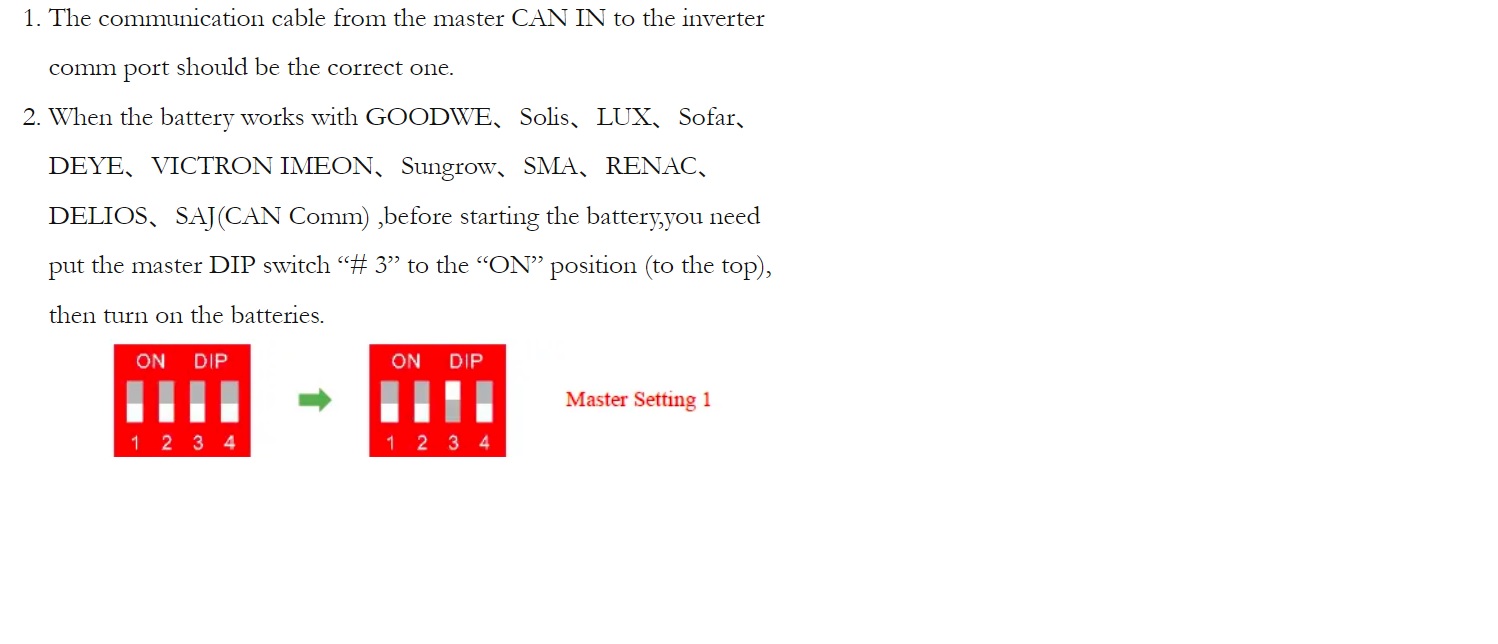

The installer set the dip switch to 3 on the battery but from what I can see in the manual it should be on 2 as I assume this inverter falls under Axpert device?

So I see the communication cable is connected into the CAN in. Shouldn't it be in the out option so that the battery let's the inverter know what to do?

Pin To 2 for Axpert inverter

Cable from Inverter goes to the IN port on the battery. The OUT port is used for intra-battery comms when you have more than 1 battery connected. When you change the PIN settings you need to restart your battery - switch it off then after about 5 seconds on again and hold the SW button for 3 seconds
