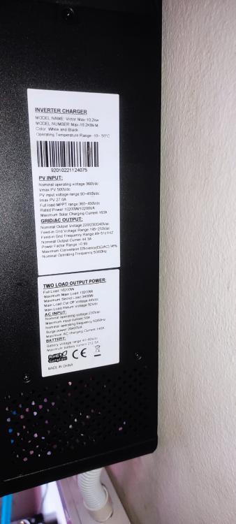

I reloaded the video at 2x speed to reduce its file size to less than 3MB for attachment purposes. I also captured a photo of the label. Today, I significantly increased the output, and the issue does not appear to persist. It seems to be caused by either a poorly calibrated or malfunctioning current or temperature sensor.

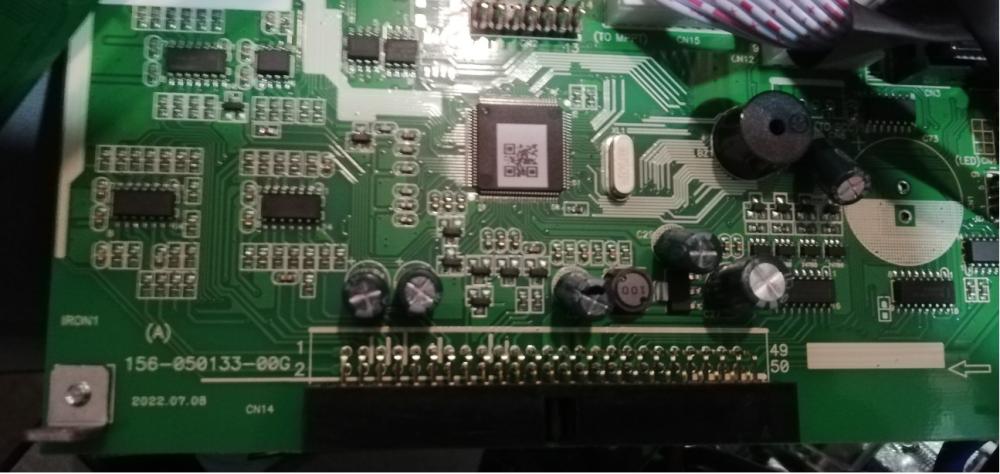

Yes, exactly as I experienced with them, they say that the inverter is 10.2kw, but it is 7.2 - 8.2kw, only colleagues who have the same motherboard, the model is 156-050113-00G(B) can tell which inverters is still used
On 2023/02/11 at 1:47 AM, valyh said:
This is the board of control board and use TMS320F28062PZ1
It looks very Axpert VM-ish. Almost certainly a clone / work-alike. The dual output back in mid 2022 [ edit: I think I misinterpreted the date code in the serial number ] is interesting; Voltronic are producing such models just recently. Maybe Voltronic are trying to play catch-up to a clone maker. [ Edit: Oops! I didn't notice that this is an on-grid model (true hybrid). So two outputs is standard for these (essential and non-essential/grid output). ]
Inside it looks quite Axpert-like. [ Edit: So it's likely some sort of Infinisolar V model or clone thereof; these are very Axpert like. ]

I have two models with the same parameters, but the blue one does exactly the same as my colleague's, it disconnects mppt, I took the control board from the white one and put one on the blue one and it works normally, I think the software is to blame, I mention that the softwares are different

I just noticed that yours is an on-grid model; it mentions feed-in on the sticker on the side. So it's definitely not an Axpert clone, but it could well be an Infinisolar clone (same manufacturer makes both). I added this to my earlier comment: "[ Edit: Oops! I didn't notice that this is an on-grid model (true hybrid). So two outputs is standard for these (essential and non-essential/grid output). ]"

Edit: Also, the sticker doesn't mention two MPPTs inputs.

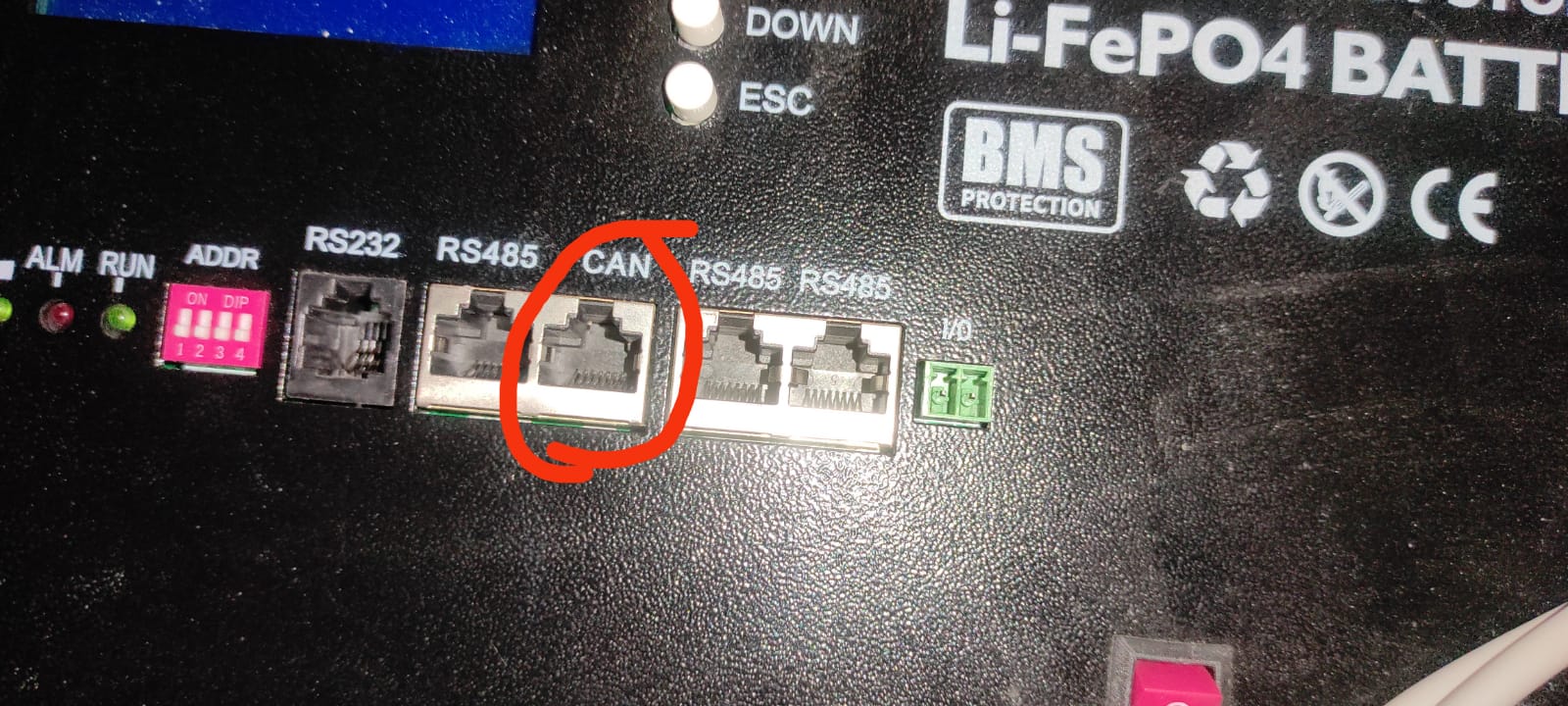

I bought victor max inverter (10.2kw) in december. I got someone to do installation for me, after installation he connected communication cable from inverter comm port to battery CAN Bus port. inverter worked for about 20 minutes and smoke came out of the inverter and the inverter switched off. Opened the inverter and found the card with comm port burned. i contacted the seller and new card was send to me, i connected the new card but inverter still failed to switch ON. The seller then send me a new motherboard, i replaced the motherboard and the inverter switch ON and worked well without without communication with the battery (Open loop communication). I wanted to do a closed loop communication between the battery and the inverter, contacted the seller for assistance but received none. Tried to establish communication and card with COMM port burned once again. I have to get a new card but i need assistance,  Anyone who knows how to establish communication between victor max IP21 and lithium battery (51.2V)

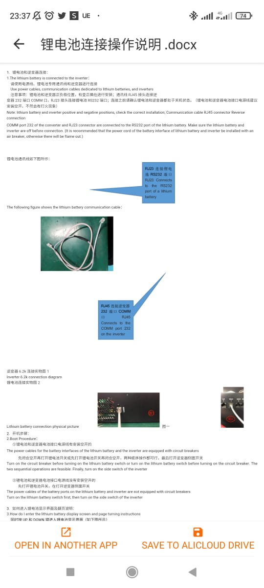

Phuti, according to Victor Max inverter manual COM port is basically RS232 port (see manual page 5).
Did you try to connect with RS232 port from battery? not sure how will react.

Hello Valyh. I'm not sure what software version is running on this inverter. i contacted the manufacture and they also told me that i must use RS232 but now the battery manufacture says you can only communicate with the battery via CAN port, so i'm confused now. I must now buy a communication cable (RJ45 to RJ23) not even sure such cable exist. I will be afraid to try this since you saying you also burned the USB converter while using RS232 port. My battery has 4 ports available( CAN, RS232 and Two RS485).

I contacted the Manufacture and they said i must use RS232 port from the inverter to the battery. I then contacted the battery supplier and they said communication on their battery can only be established via CAN port and not RS232. so i'm a bit confused now while waiting for the new RS232 USB converter for the inverter

@Puti: You made a big mistake and damaged the inverter by connecting the battery to the WIFI port. Fortunately, you found an incompetent seller, so the breakage is still covered under warranty. The battery must not be connected to that port!

@Talino8Thank You. Does this mean this inverter works only on open loop communication with the battery since there is only one port (COMM)?. Luckily the warranty covered everything, the seller is going to send me new card and i'm advised to use RS232 on the battery instead of CAN port
