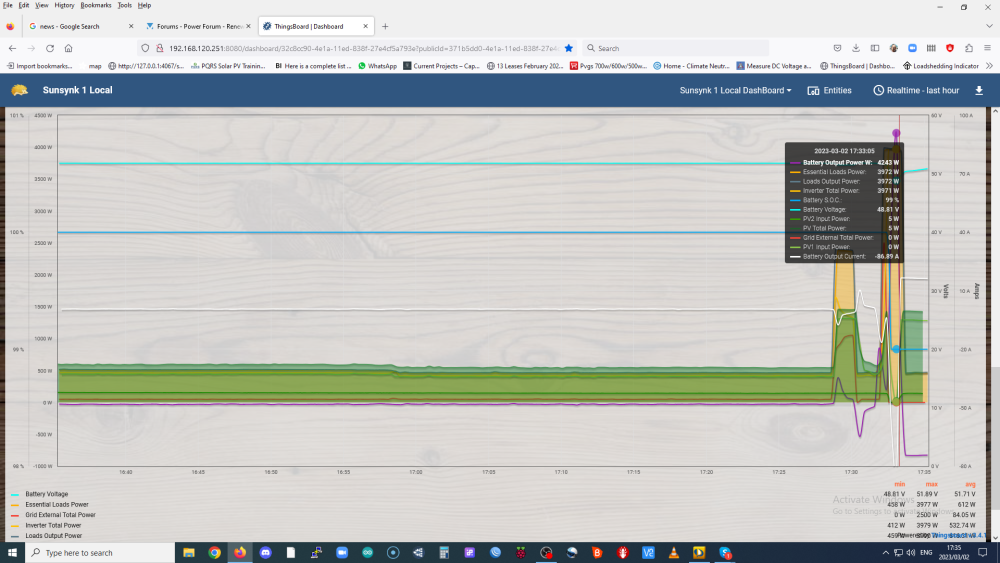

My base load of average 400 watts, and then have the microwave and kettle running brings the discharge up to 86 amps so about 43 amps per battery.
Most definitely if you are going to often exceed 50 amps draw then you should be aiming for a minimum of 2 batteries to ensure your investment has enough life to pay for itself over time :)
What I personally would rather focus on is the ability of the BMS to allow/deliver 1C discharge as that is mostly the limiting factor on these systems.
On the screenshot below I switched off the solar and eskom to see exactly what would be pulled from the battery with the base load, kettle and microwave.
Edited by WannabeSolarSparky
