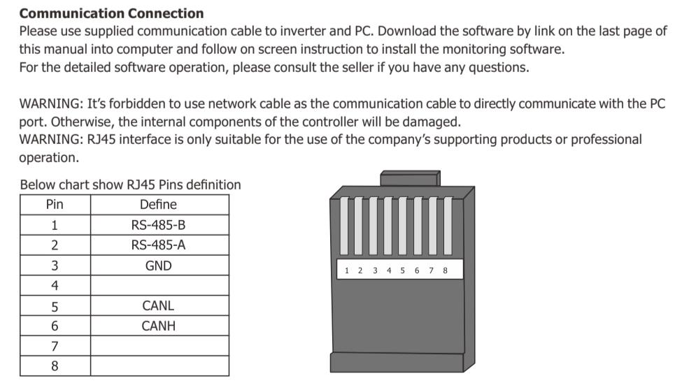

The inverter manual indicates that COM (port 12) is for RS-485 communication and the battery has 3 ports for RS485 (CAN, A and B). Does this mean I use the supplied cable to connect the inverter to the battery - and if so, to which RS485 port on the battery? Will other settings need to be changed as well? Also noteworthy is that on battery type setting 14 on the inverter - I do not have the option of PYL as indicated in some of the (google!) research I have done.

As for the inverter, the COM port actually has RS485 and CAN lines.
You might need to crimp your own RJ45 cable, using only CANL, CANH and GND.
As for the battery, I really don't know where its supposed to connect.
Maybe you can refer to its documentation, or get help from someone with a similar battery.
