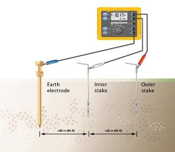

July 27, 20233 yr 40 minutes ago, GamezBond said: i also saw this error on mine. there are 2 pv strings coming into mine. turns out that one of the strings was shorting to the DC earth (I HAVE A SEPARATE DC earth dug into the ground. after establishing this as a possible cause by testing between the Dc earth connected to all the panels and pv positive input i disconnected that one pv string and everything seems to be fine. my errors used to come mainly at night and i saw F18 and F23 both on different occasions. This is the reason why you need to earth your solar array at 2 points if using an earth spike. One wire running to your earth spike and 1 wire running back to the main earth bar in your utility(Eskom) db board. You don't always get a good ground(earth) from your earth spike it depends on the soil resistivity it varies throughout the country. Spike installation should be tested by uising Fall-of-Potential test method.
