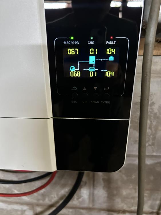

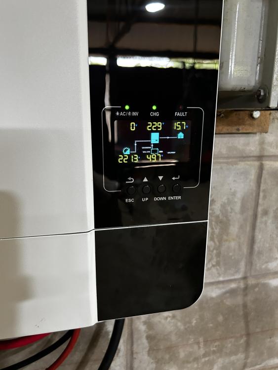

Cdninperu Posted May 31, 2023 Share Posted May 31, 2023 Just installed a Growatt SPF 5000es into my system I had a Sigineer 5000H and they both have the same problem they won’t charge the batteries. Good voltage coming from the array supplying ac to the house but won’t charge. 48v flooded batteries Quote Link to comment Share on other sites More sharing options...
zsde Posted May 31, 2023 Share Posted May 31, 2023 Not much to go on here. Provide the detail and specs of your total system and also your current settings on your Inverter. Scorp007 and Antonio de Sa 2 Quote Link to comment Share on other sites More sharing options...
Buyeye Posted May 31, 2023 Share Posted May 31, 2023 The spf 5000es is a straight forward machine either you installed everything correctly or you haven't. Show us a picture of the voltage screen. Cdninperu 1 Quote Link to comment Share on other sites More sharing options...
Cdninperu Posted May 31, 2023 Author Share Posted May 31, 2023 Quote Link to comment Share on other sites More sharing options...
Cdninperu Posted May 31, 2023 Author Share Posted May 31, 2023 Thanks for the response. If I run the generator the solar will go to charge the batteries as the gen supplies the ac load. If I don’t run the gen the solar and batteries only supply the ac load. Is there a way to set it so the solar charges the batteries as the first priority? That’s what my old one did. It would always charge the batteries first. Quote Link to comment Share on other sites More sharing options...
zsde Posted May 31, 2023 Share Posted May 31, 2023 (edited) Your Solar voltage at 131,5V. Is this in daytime? How many panels have you got and what is their configuration and specs? This inverter has a MPPT startup voltage of 150V + or - 10V State all your program settings from 01 through to 23 Edited May 31, 2023 by zsde WannabeSolarSparky 1 Quote Link to comment Share on other sites More sharing options...
