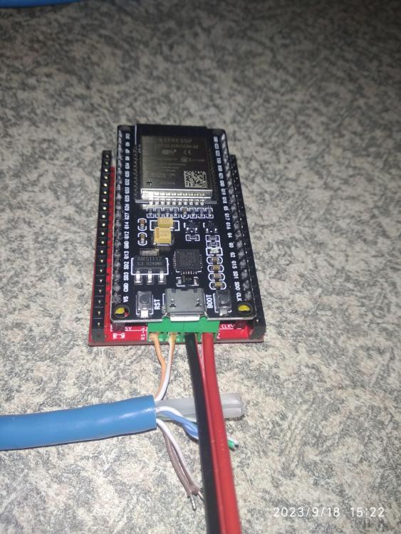

September 30, 20232 yr Author diagram for the connection of the RJ45 cable. I see you marked you power input with Black and Red mark. Have a look at the online store, there are a couple of high resolution images that will tell you what you want to know. smarthomeintegrations(dot)co(dot)za The ESP32 Microcontroller USB port always needs to face the same direction as the power port marked with red and black (input 5V-16V DC) RS485 (Orange left & Orange/White to the right) or brown/white left and brown right (assuming you crimped T568B)

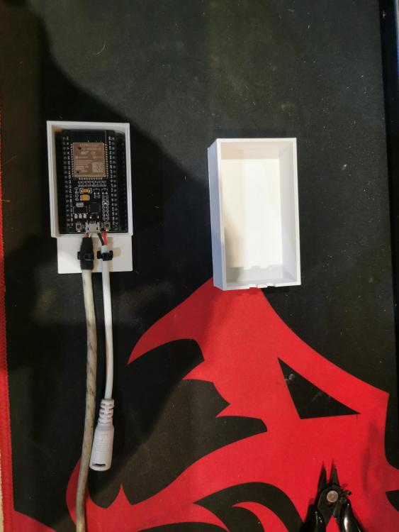

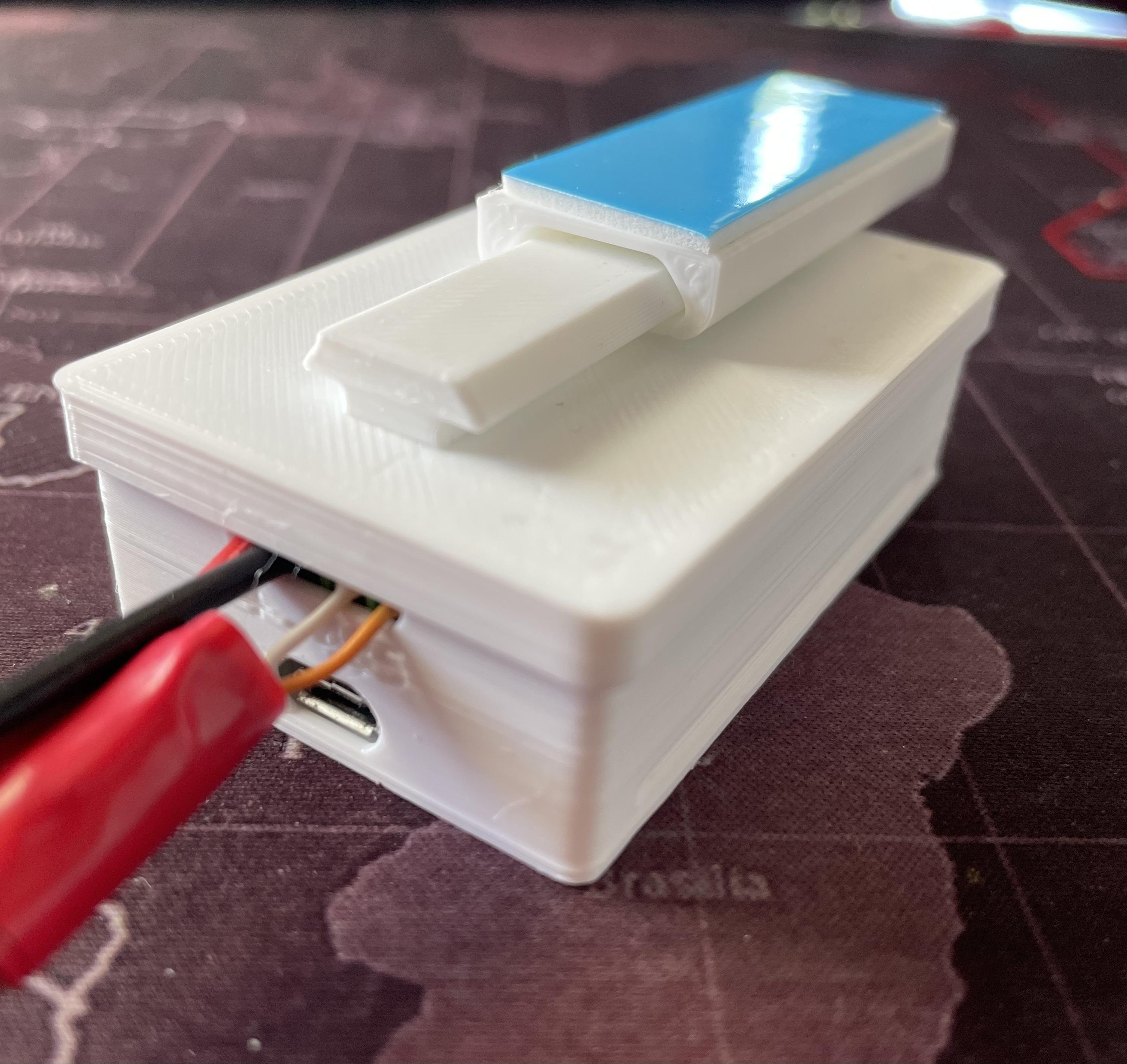

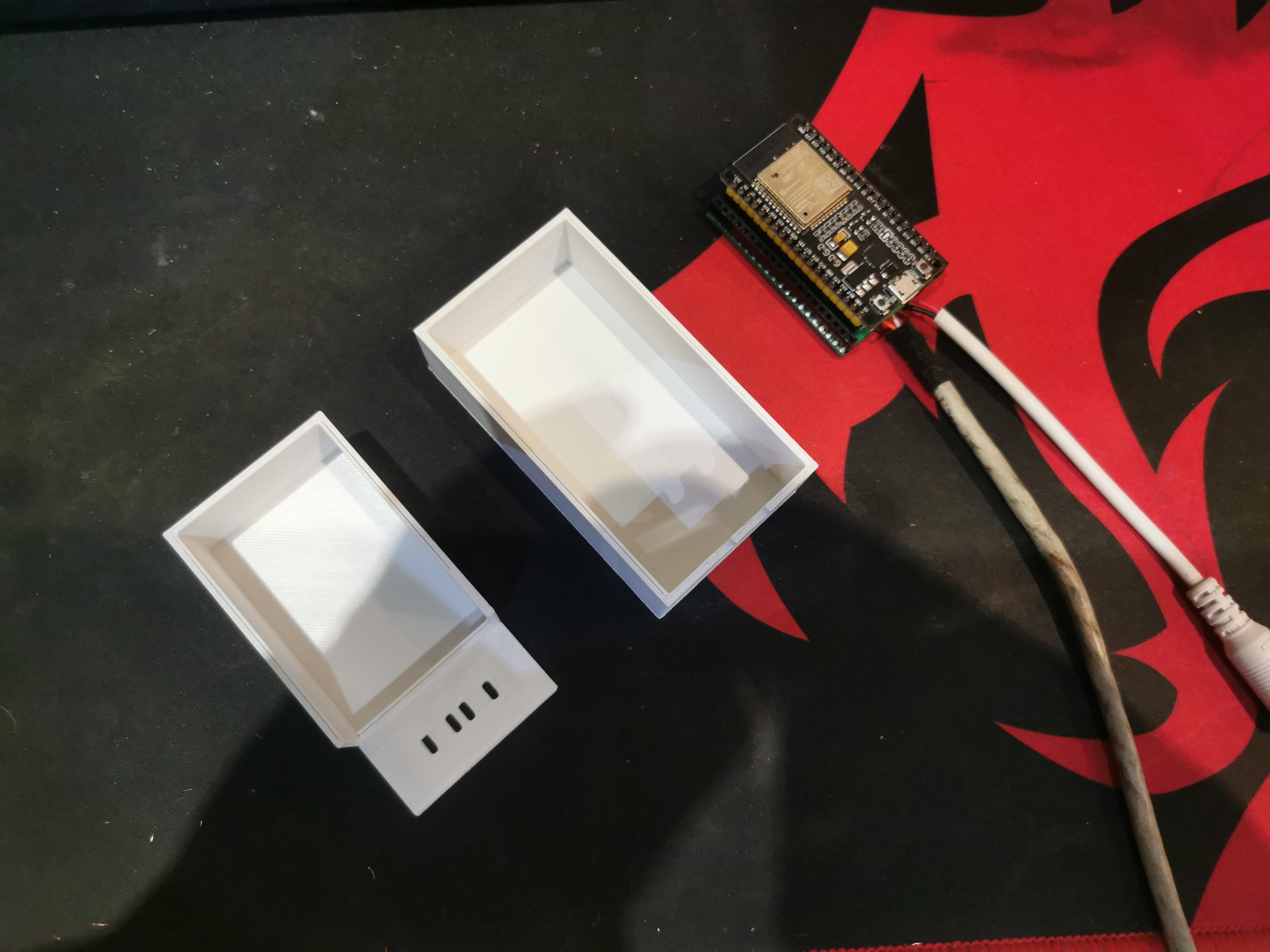

October 8, 20232 yr https://cad.onshape.com/documents/103030e2eca3ada69e400db3/w/586a90b4aaa4edff7b31a60d/e/68c1384c802ba5f205098b56 For those that want to 3D print a box Pretty simple, with holes for small cable ties to keep the cables secured Edited October 8, 20232 yr by Jaws

November 21, 20232 yr As I dont have a 220 V plug close to my inverter to power the module so it was a bit of an issue. I ended up simply powering up the unit straigh of the inverter. I bough a R30 DSub 9 cable from Geewiz and found 12V between pin 9 and the outer ground of the connector (serial port were the wifi dongle usually connects It has been working perfectly. I dont use my wifi dongle so this works for me.
