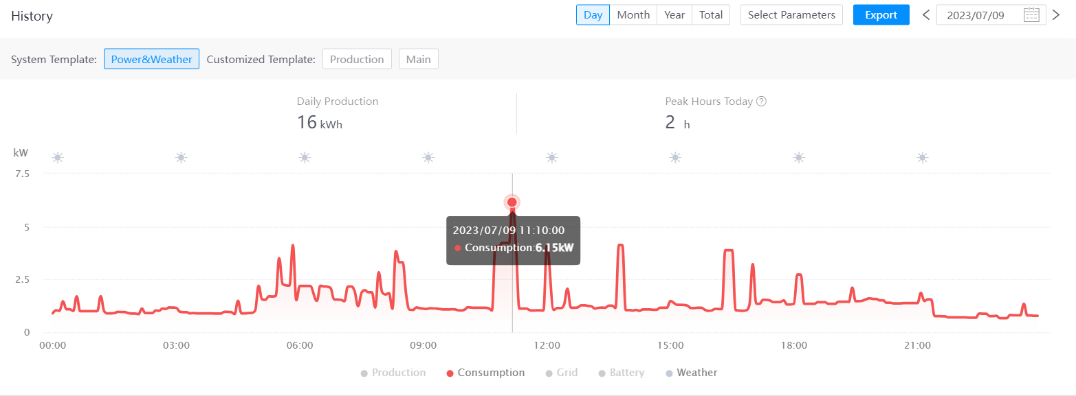

as you will see in the attachment, the office doesn't pull constant high load. it is only when the one geyser is switched on and then someone makes coffee.
there are 3 small kitchens meaning 3 kettles and fridges.
the geyser is also on a smart breaker that is programmed to come on certain times of the day, and would also be integrated into home assistant to be controlled with too little PV or loadshedding kicking in.
so, my plan is to regulate the load. this is when teamwork comes in and everybody should work together.
I am going to install smart lights that works with home assistant, so they will be alerted when it is loadshedding to not use as much power as normal.
then I would also like to implement lights that home assistant switches on when the load reaches let's say 9kw. so, then they know they should not switch on equipment. (This will be when someone throws in diesel for example.)
so, I would like them to keep the load at a minimum.
I do understand that you should not over work the inverter, but I'm sure with this "ruling system" we should stay under 10kw (if it spikes higher it should just be for a min or 2)
the main concern is that I will not be able to do load balancing to the T, as all the 3 phase items will pull from all 3 phases and then there is the single-phase items that will be split. so is it possible for the inverter to handle different load on different phases.
