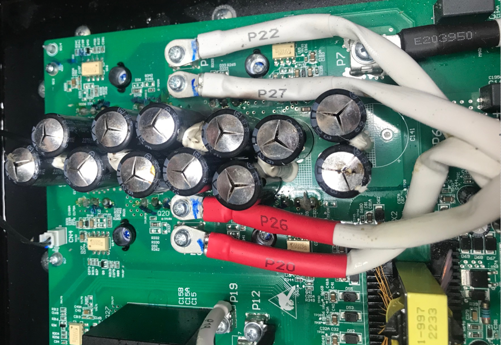

Hi guys, as you know a few months back we purchased a defective Growatt SPH3600 from someone who installed wrong batteries to it ... seems he installed HV batteries and all the capacitors on the battery side went bye bye ...
We purchased this unit in the idea of trying to fix it and use it as test unit or secondary inverter or something like that.

My experience has been that generally with broken electronics, you'd need to find someone who could assist and do the repair themselves - seldom will the manufacturer assist. Is there a part number for that board? Perhaps you could find a used one online somewhere? I think that will be the best as good luck trying to get the schematics.
The big caps are easy enough to remove and buy replacements for, although the SMD caps will be a problem as you won't know their value and then checking to see what other components might need replacing could become a bit tricky.
How high voltage was the HV battery?
If it's 48 V battery to a 24 V inverter that's one thing, but if it was a 400 V battery to a 24 or 48 V inverter, then there will likely be a lot more damage than just capacitors.
But true HV batteries are still pretty rare.

Thanks for the suggestions. I am in negotiations with the eBay guy , but those boards are not for SPH3600 ... if we come to an agreement with shipping then I will just upgrade to SPH6000TL in the SPH3600 cabinet :)
I can change the big capacitors myself , that is not a problem , but as you say , I do not know the values of the small ones and that is the main problem.
Not sure how high voltage ... it was an installer that got it from an enduser and got it for free as is .. so I did not ask to many questions as we bought it very very cheap.
