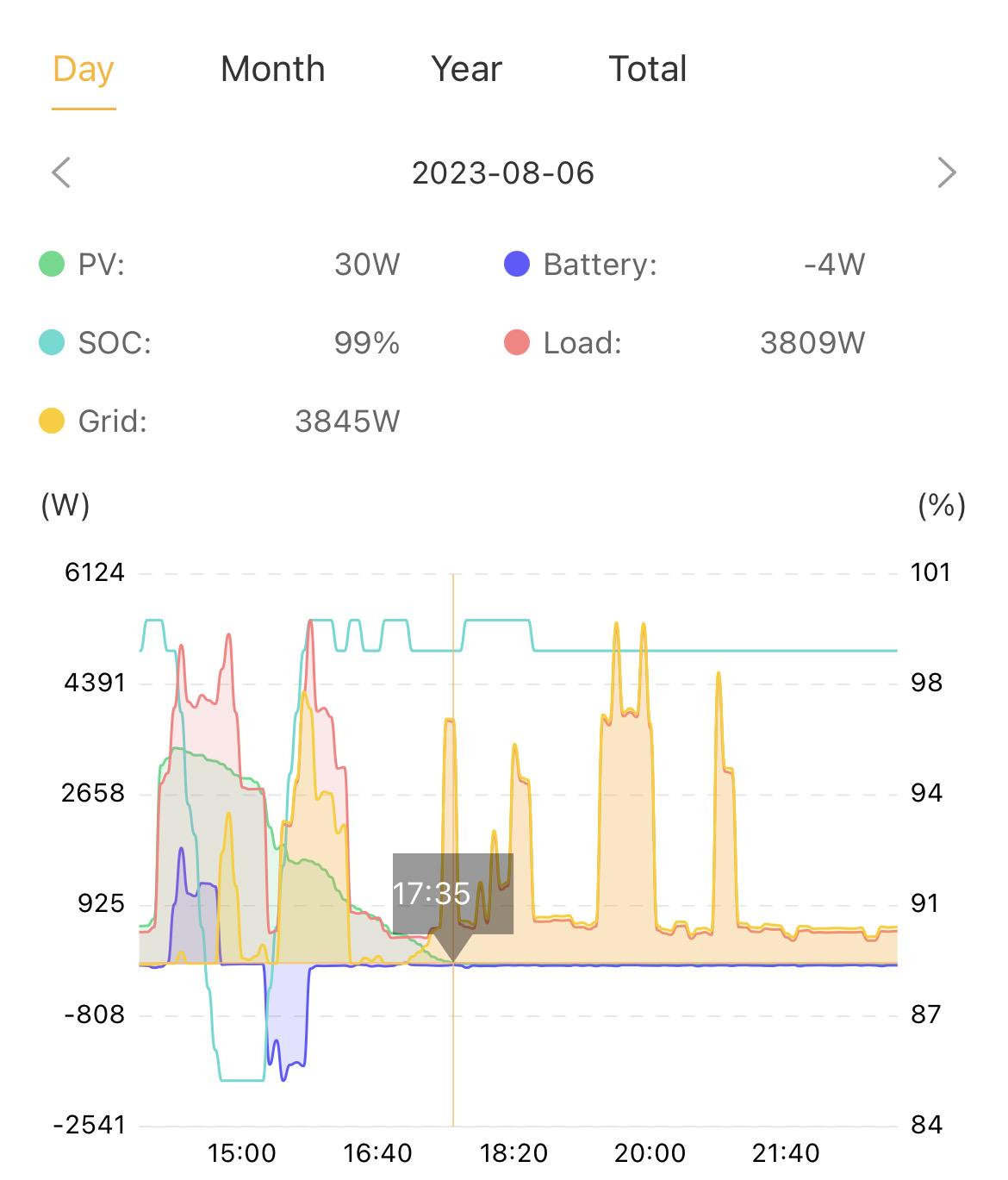

Here's an example from a day or two ago of the 99%-100% fluctuations on my AM-5; the SOC target for that time-slot is 100% - it happens during PV use as well as post load-shedding; both scenarios dip (at least very slightly) into battery; it hits 100% briefly and then settles on 99% the rest of the time (despite the 100% target); this does look like cell balancing to me:

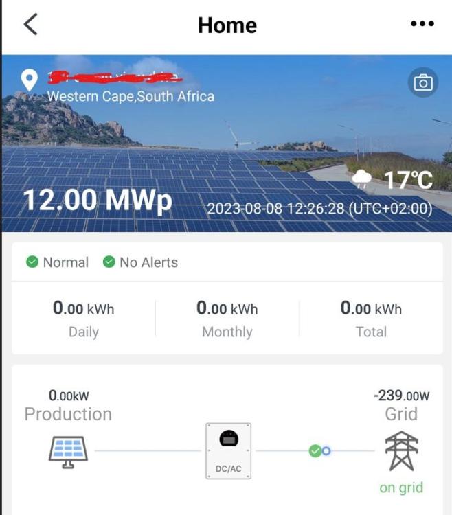

Funnily enough, I just noticed that my inverter seems to be pushing power back to the grid!
Can this be due to the CT clamps being the wrong way around ? Where should they point ? Inverter or utility ? Seems to be mixed options on this...

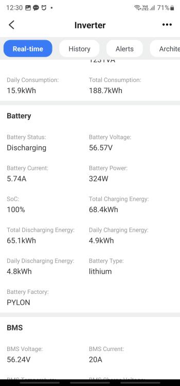

My SOC is sitting at 100%, but battery status is discharging.
Really weird..
12 minutes ago, ZA Moose said:
Thanks for all the advice and feedback.
I do not have any solar installed yet, This is just a straight up backup power system at this stage.
I have spoken to the supplier and they are going to check the battery firmware version for an update and see form there.
Really weird..
So my battery is usually at 100%, then in that Battery Status field it says Static, whatever that means, but it still draws around 20W, presumably to feed the BMS electronics. Not sure why you are seeing discharging. That -239W to the grid is problematic. It is probably due to your settings, check if it limits feeding back to the grid. Even if the clamp is the wrong way around, I would not expect the inverter to say -239 as the inverter would try to stop any negative currents.
I agree it's completely weird..

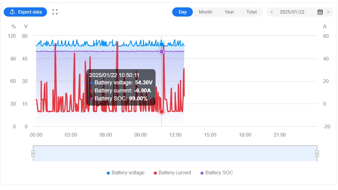

Hello, everyone!
We have the same problem with our UPS station consisting of three Deye SUN-12KSG04LP3-EU inverters in parallel mode and eight Deye SE-G5.1 Pro-B batteries.
The problem is that the Inverter cyclically charges and discharges some batteries from the assembly, reducing their service life and wasting electricity. Because of this, the batteries gain cycles unevenly, in fact some batteries wear out more that twice as much as others. This happens if you set the SOC level of the batteries to 100%. At the SOC level of 98%, the battery becomes static, but the calibration and balancing of the batteries of the assembly does not occur.
As we managed to find out, the inverter  charges the battery to the  voltage 58.4V, then it begins to discharge it to the voltage below 53.0 V. At the same time, the SOC of the batteries starts to drop, and when it drops to 99% on one of the batteries, this battery starts charging again to the 58.4V level, and so on in a cycle.
Is it possible to do something about this problem?

On 1/28/2025 at 11:39 PM, mikerin said:
Hello, everyone!
We think that the problem can be solved by making a change to the firmware, for example, by lowering the threshold for triggering the additional charge to 98% or by changing the logic in some other way so that there is no wasteful cycling of the batteries. But
[email protected] does not see the problem with it.
PS/ The firmware of the units is up to date. maybe using Butt V or % will solve the problem, but we can't disable the connection with BMS for security reasons.spacer.png
I think this issue is due to the inverter is pulling power from the battery to be ready to switch rapidly to it if the power went off ( UPS functions)
