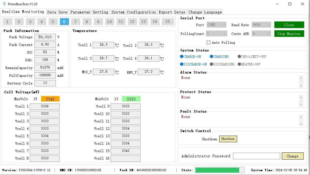

I had same problem with my LEOCH 48100-TB packs. The setup with RS232 according to the manual didn't work. Finally the supplier came up with the solution:
Create a communication bus with all RS485 ports on the packs in parallel and connect with an RS485 adapter to the laptop. Also needed to change the software to PmodbusToos V1.20. Each pack must have a different address set by the dip switches. This way I can remote monitor every pack individually but not simultaneously. There is no master, all packs have same priority.
