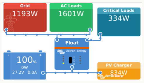

@Anthony like so, at 4pm in Cpt:
Critical loads are all computers, the loads that are on most of the day.
AC loads the entire rest of the house, 2 separate homes.
1330w array can max give 834w this time of the afternoon.
So it is nicely off-set against what comes from Eskom - ALL the panels can give is used. Solis will do the same.
