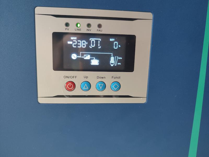

I have a "Mecer SOL-I-BB-M2L Mecer 2Kw 25.6V 100Ah Lithium Battery 820W MPPT" that I purchased a little over two months ago.
I've run into an issue where it is no longer charging the battery, and has run empty as a result.
It is only plugged into the main and receives power.
I've tried pressing the "battery switch" and "AC Input Protect" switch at the back while both plugged in and not, but it made no difference.
I've also tried switching it off at the front while leaving it plugged in while on setting 01 - P3, which is supposed to just charge the battery according to the manual.
It could just be because the battery has now run empty, but it appears that the Battery Switch isn't doing anything. I'm not sure what caused this, or how to fix it.
Any assistance would be greatly appreciated.

I guess that photo is from a time when it was working, not from the last charge cycle. It would be good to know if the inverter thought it was charging, or had some sort of fault code showing.
I'm not familiar with this model. What does the 01 in the middle signify?

Is that not the normal fault code as used by Voltronic inverters. Code 01 is normally the fan blocked which does not seem of value here.
It might be of value to see the current screen of the inverter even when in line mode.
To answer the questions. The green light for "Line" indicates the inverter is receiving power from the mains. The [01] indicates the charging type (in this case, priority from the mains, then battery as a failover). And the 0% under BATT indicates the charge level for the battery.

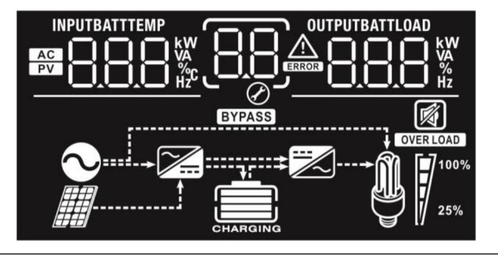

Good to hear at least you making progress. We were expecting your display to match the Axpert display as your LEDs as well as 4 buttons do match the Axpert.
In this picture of an Axpert the display does not show which priority is selected. Those Centre 2 digits are reserved for the setting number(tool) when changing settings or for the error codes. (!)
Always a problem to know what the display implies when having a different make or family.

Yes, for a long time I thought that the above LCD pattern was designed and manufactured by Voltronic for their Axperts, and that any other inverter manufacturer that used it was illegally copying it. Whether that's true or not, it seems now to be a commonly available component, and is used by many manufacturers, not all of which are attempting to copy Axperts or to necessarily look like them.
As for the four buttons, again it looks like copying the Axperts / Infinis, but on the other hand, it's a sort of usable minimum user input system and you pretty much always need an up and a down button, etc. So it's not that surprising to see this.
You could say the same thing for the four LEDs, but taking together these three aspects (LCD, buttons,  and LEDs), it does seem a bit much of a co-incidence. Perhaps they thought that looking a bit like a well-known, fairly well respected brand is no bad thing, while taking steps to ensure that there was some differences that they could point to in court, should the need ever arise.
We will try and remember which with age becomes difficult that the multi color buttons on a Mecer does not correspond with the Mecer models that are not housed in a trolley.
We too easily assume the same make will use a standard display unit as well as the same codes for various settings. A selection of displays without the new large display.
