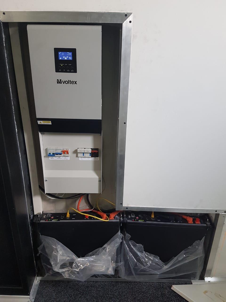

I wasn't in the mood to take a generic photo of the 6 x 330w Canadian Solar panels on the roof of the container, but here's the guts of the control gear mounted to one of the container walls. It's all flush with the insulated drywalling so it takes up no space at all. The solar panels flat-mounted on the roof also serve as a 'safari-roof' and keep the container cooler.

Why does the Axpert stop charging from PV during the day when there is a sustained draw on the batteries?
Could it be overheating?
I 'hard booted' it and it started happily accepting charge form the PV again.
Thanks in advance, Paul.

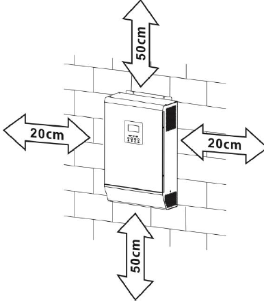

Definitely. Inverters of any kind need a decent flow of air, and they are supposed to have some 200 mm of clearance around them.
Yeah, it's not that. The inverter is essentially mounted to a giant heatsink in a temperature controlled space.
