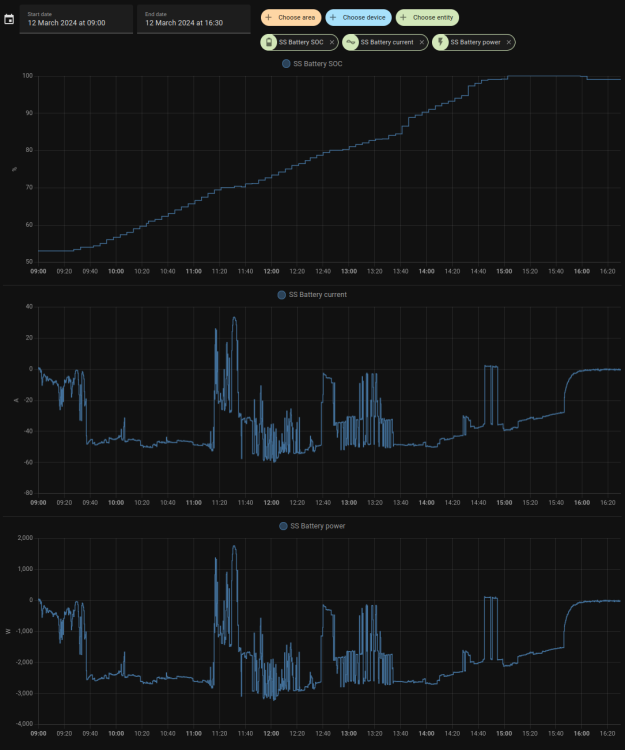

March 13, 20242 yr 1 hour ago, SiriS said: I've run out of technical expertise...so would this indicate a BMS issue or a faulty cell issue in perhaps the Master battery? When the battery gets charged, is it from grid (it would appear so) or from solar? LiFePO4 batteries usually report 100% SoC well before they are really full, then they would still consume lots of amps to balance and actually get the cells full, look at my charge for yesterday, the BMS reported 100% at 15:03 app. but the batteries still took current until an hour later, by which time they were pretty much full... Edited March 13, 20242 yr by Kalahari Meerkat typo & forgot to attach screenshot...
