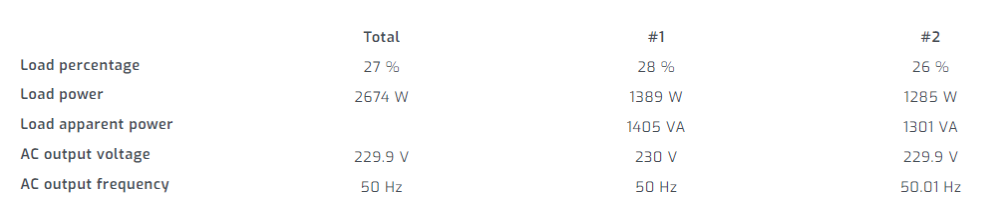

If you have a load of 5kW each inverter will supply around 2,5kW,  it shares the load at roughly 50% of the total on each inverter.

Here is a snapshot of my two Inverters sharing the load. This is from my monitoring software. You will see the total load and then the roughly 50% of that load supplied by each inverter
