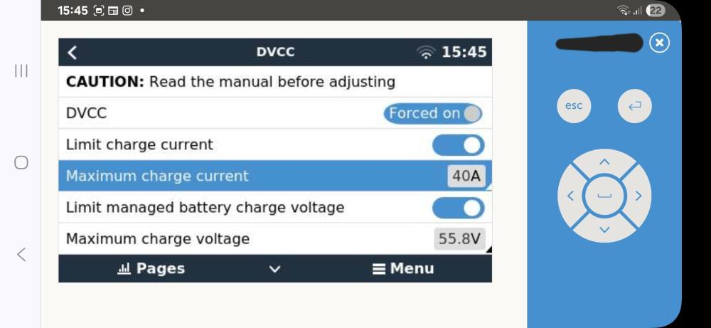

Both lifep04 batteries at rest with a delta of 13mv 100%soc charged at 0.2C, charge voltage 55.8v (as stipulated by FW) DVCC(Dynamic Voltage Current Control) setup on Victron Multiplus II The "forced on" means both batteries are controlled by the bms's.
Edited by TaliaB
