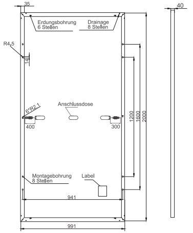

You would aim for a mounting bracket at least every 1.5 meter or second truss. The hardware is pretty standard, the rails will connect to the mounting bracket. from there you space the the rails so that the two rails fall within the clamping zone of the panel. The picture below should make it more clear. Please note the rails orientation differs for portrait or landscape mounting. So if you can buy the brackets now and space them correctly, you can add the rails later. Your plan can work.

Most of the panels from 335 Watt to 400 watt is in the region of 2 meters long. The rails to mount a 2 meter long panel should be 1.6 meter apart.
