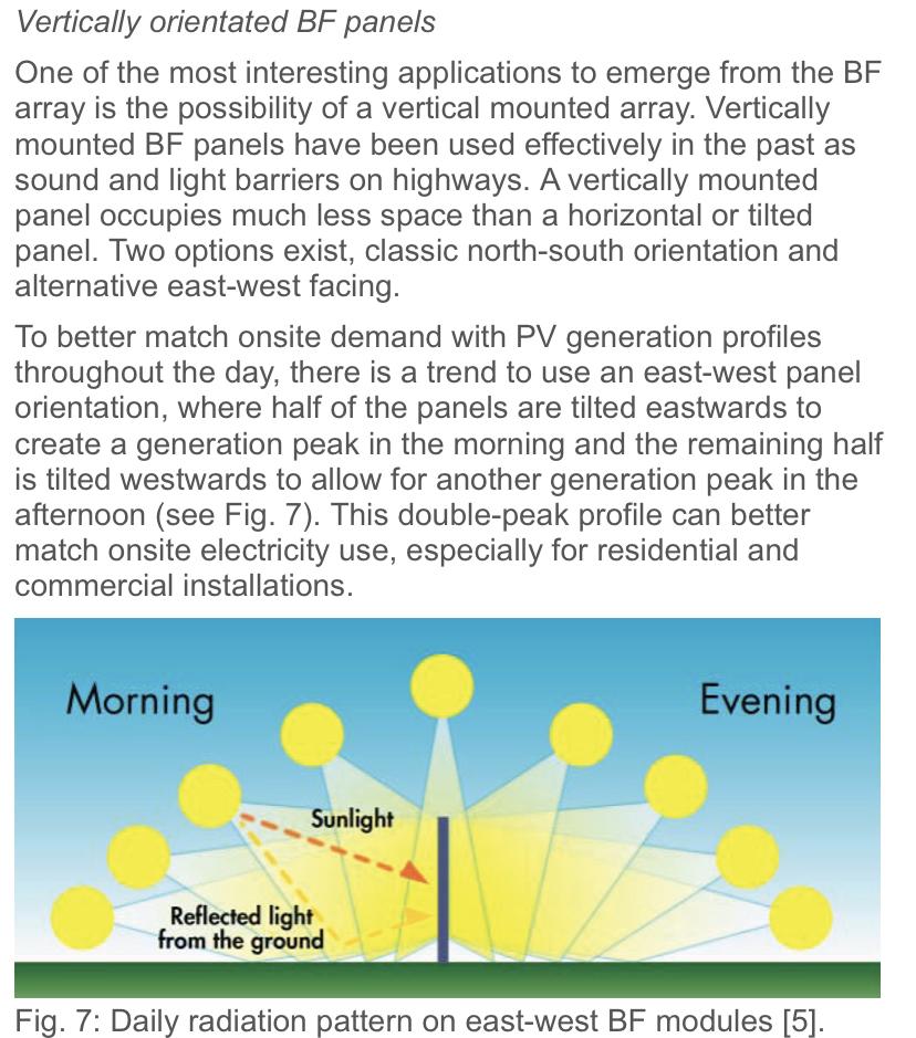

March 21, 20206 yr Hi All, As I continue my solar research, I came across the bifacial panel option and I want to sound board my thinking. Traditionally convention dictates a north facing install. Now, as I am installing a Goodwe ES with 2 MPPTs, I was thinking: - Install 1 string of 4 panels (350-400W) north facing on the roof (traditional racking) - Install 1 string of 4 panels facing West. This will help optimising production during my peak usage (Western Cape and late sunny evenings) BUT - seeing that this will be on a flat roof section, which will then require a tilting racking system I am wondering whether Bifacial panels will not be a great option here as I should then get very good production during the morning when it hit the back of the panel? (for discussion assume no shading issues) Secondary question Can one do 2 west and 2 east on the same string and MPPT? (See snippet from article attached) Secondary question Assuming a VMP of 50V, what wire thickness do I need for a string of 4 and 15m cable length. Online calculators give me different answers of 4 and 6 mm2.
March 21, 20206 yr 11 hours ago, daniemare said: Can one do 2 west and 2 east on the same string and MPPT? (See snippet from article attached) No. Not in the same string. But when you make 2 strings out of it and parallel them on 1 MPP tracker that's no problem. Interesting topic, do you have an example of such a panel?
March 22, 20206 yr Author 10 hours ago, RikH said: But when you make 2 strings out of it and parallel them on 1 MPP tracker that's no problem. That was my intention. see attached for example Also full article of idea https://www.ee.co.za/article/bifacial-solar-pv-modules-give-increased-power-output-potential.html#.XncAKyWxUlR Canadian_Solar-Datasheet-BiKu_CS3K-MB-FG__IEC1500V__v5.57_EN.pdf

July 28, 20224 yr Bifacial factor for panels available in SA at the moment is around 70 to 80%, but will go up when N Type panels arrive later in the year. It's an interesting topic and I've been thinking about how I'd test it out at home as well, based on articles I've been seeing about the positive performance of vertical PV systems and Agrivoltaics. You would need to separate your MPPT strings into at least 3 for maximum solar capture: North facing, East facing, West facing. That will allow you to maximise your power output curve. I saw a graph of this yesterday where the vertical mounting gives you a double hump output graph alongside your single hump of the North facing panels. https://www.pv-magazine.com/2022/07/11/the-stabilizing-effect-of-vertical-east-west-oriented-pv-systems/
