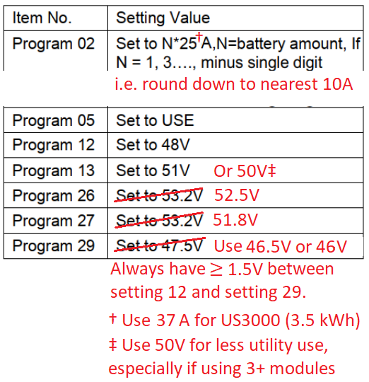

Dirkie Crous Posted February 2, 2021 Author Share Posted February 2, 2021 On 2020/07/17 at 2:38 PM, Dirkie Crous said: Afternoon, Current installation: 5KVA 48V inverter. 2 x 2.4KWH Pylontech batteries connected to 4 x 330W panels and 4 x 340W panels. Works very well. Want to get the maximum of the solar power available. After sunset it stays on battery power for while and switch to utility. The SOC lights shows four still on (66%). According to Pylontech the batteries can be discharge to 20%. Which inverter settings need to be change to achieve this? Regards, Dirkie Crous Good Afternoon, Want to add a third 2.4 Kw/h battery to my current system. Do we need to change any settings on the inverter? Please advise Regards, Dirkie Crous Quote Link to comment Share on other sites More sharing options...
Coulomb Posted February 4, 2021 Share Posted February 4, 2021 On 2021/02/02 at 8:18 PM, Dirkie Crous said: Which inverter settings need to be change to achieve this? Time to trot out my criss cross diagram again, I think. Maybe I could do a neat version one day? Quote Want to add a third 2.4 Kw/h battery to my current system. Do we need to change any settings on the inverter? Just the maximum charge current (setting 02), to 70 or perhaps 80 A. Quote Link to comment Share on other sites More sharing options...
Dirkie Crous Posted February 4, 2021 Author Share Posted February 4, 2021 Thank you. Will implement. Regards Quote Link to comment Share on other sites More sharing options...
Dirkie Crous Posted July 19, 2022 Author Share Posted July 19, 2022 Morning. Current system, 8- 340W panels, 3 - 2.4Kwh Pilontech batteries. Inverter settings: 01- SBU. 02- 70A. 03 - UPS. 04 - SDS. 05 - USE. 06 - LRD. 07. - TRD. 09 - 50Hz. 11- -20A. 12. - 47V. 13 - 50V. 16 - OSO. 18. - BOF. 19. - ESP. 20. - LON. 22. - AOF. 23 - BYE. 25. - FEN. 26. - 53.2V. 27. - 51.2V 29. - 45.7V. 31. - SBE. Add four 340W panels and one 2.4Kwh battery to the system. What settings need to be Change to accommodate this upgrade? Please advise. Regards Dirkie Crous Quote Link to comment Share on other sites More sharing options...
