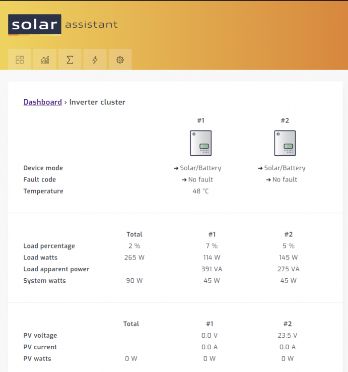

Hi Coulomb, i have both invertes in paralell so i can share the battery bank. But the have different load and different AC input. The system works great, but i seem to found the problem. When you are in SBU and you are consuming more than the solar and battery can give you, the system doesnt get a third input involve ( grid ). I connect the system to solar assistant and home assistan a looking into the graphs i realize this. I have only 4.400 kw per inverter now so when the load exceed this it will drain battery right? But i had the inverters at 130amp max discharge current and then go to grid, but when solar is high and batteries are full, the system doesnt go the grid. Next month i will be installing more panels to get to 10k each inverters then im sure that the problem will go away.
Hi, i found the problem in my setup, do cause i have different load, the sharing load cable should not be connected. i allways said to everybody else always read the manual full, well i didnt read it all of it.
i need to do it like this in order nothave the error. 3 days and no error still
