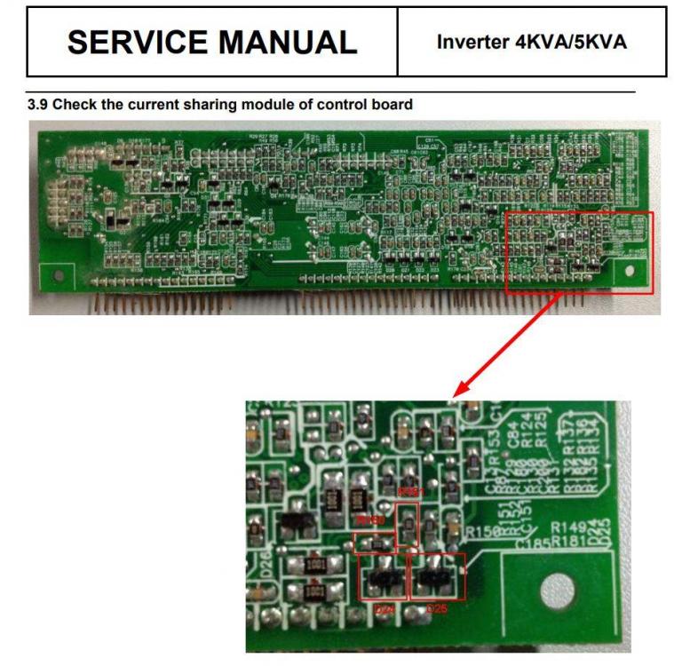

13 hours ago, Vladimir said:
I found a likely solution in the service manual.
Oops, I didn't see your follow up on the new page. Yes, I guess part of the amplifiers for the current sharing might be on the control board. They might be connected with pins 3 and 4 of CN9, called O/P J+ and O/P J- respectively on some schematics.
