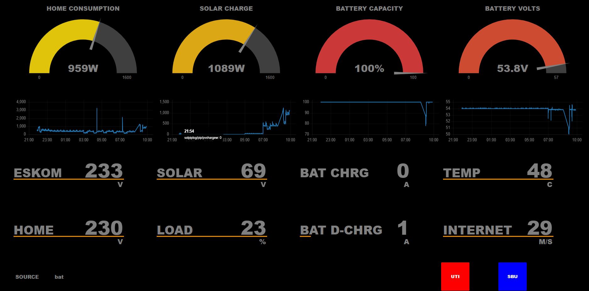

Actually an Axpert clone. when I bought it, I never knew that there was clones. As I said before, the salesman was there to make money. Searching the internet for inverters, no where were stated that "this is a clone" and "that's the genuine thing". Another guy at Solarmid (small solar shop where I live) told me that it's fine, but I should never use more that 50% load, otherwise it will pop the mosfets. Highest it goes is 35% load for my needs. This Node Red screenshot is at 10:00 in the morning with everything I need running, (including air-con @ 24 degrees)

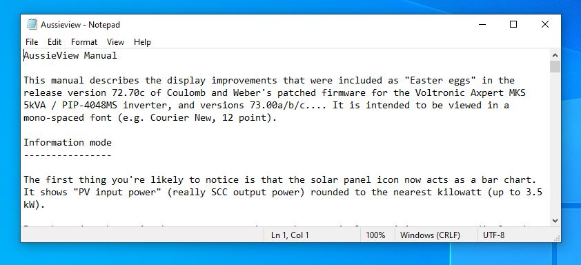

I will change the absorb time to see what happens. The inverter uses your and Weber's firmware and I'm working off the Aussieview manual.
