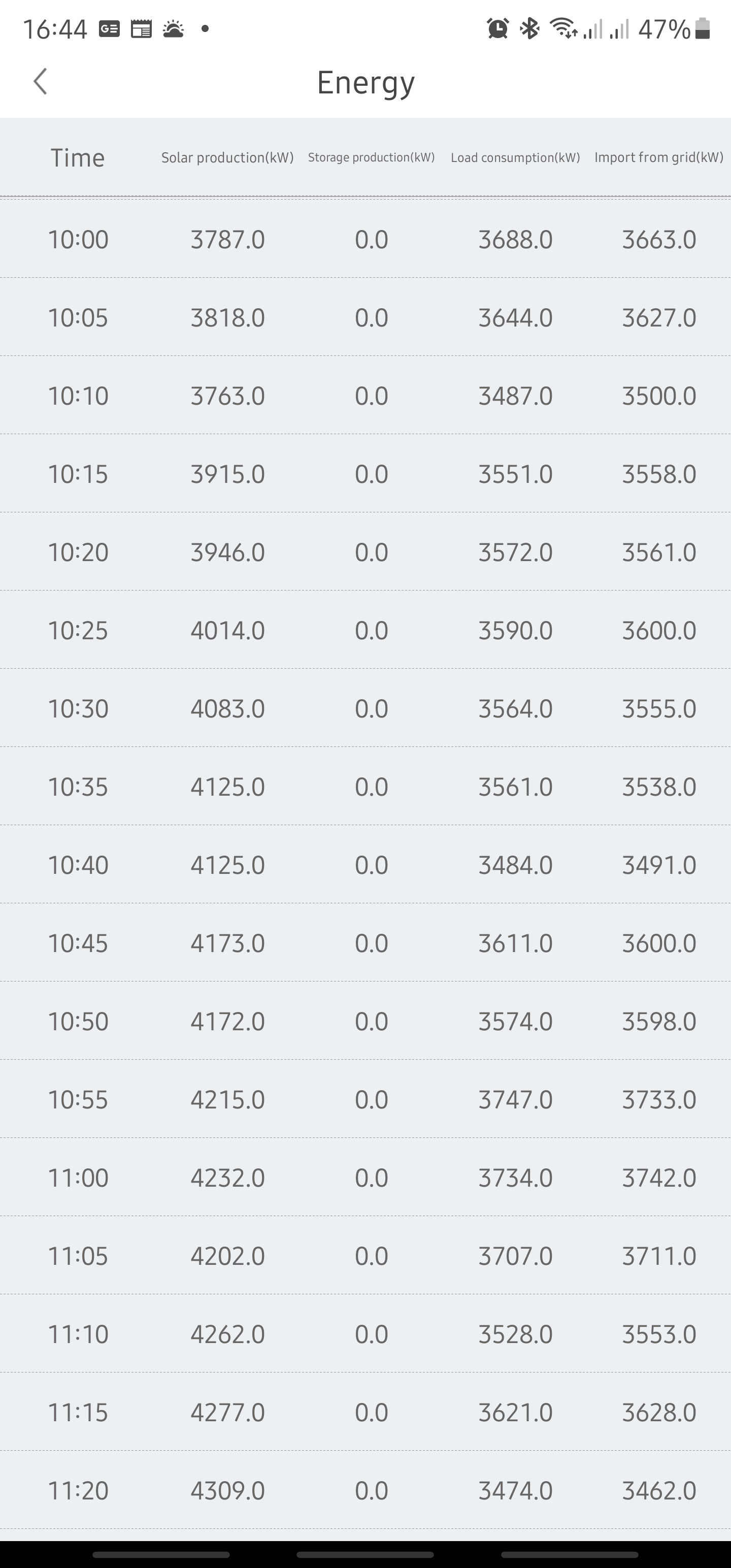

My growatt spf 5000es does prioritize pv to load. See screen shot. In the screen shot you will see that my pv tries to provide the load and the utility fills in the rest. The monitoring software isn't able to record it properly.  On the inverter screen you can see that no amps are coming from the utility.
Still I would advise spending the extra R7k and get a deye.
Came across the growatt spf 5000es earlier and the wording of the manual looked very much the same as the voltronic rebranded inverters which made me doubt it (not sure if it is also a voltronic rebrand) but if this one works then awesome.
From the screenshot, shouldn't Load consumption = Solar production + Import from grid? Or is that what you mean by the recording isnt done properly?
You can see the Solar production is going up from 10h00 - 11h20 which makes sense but the Load consumption and Import from grid are fairly constant
Your maths is good but the monitoring software only takes snapshots every 5 minutes so the math ends up being wrong.
Other than that I'm happy with the inverter. I do get upset with myself for not spending the extra R7k at the time but the truth is I didn't have it at the time.
