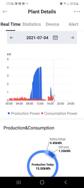

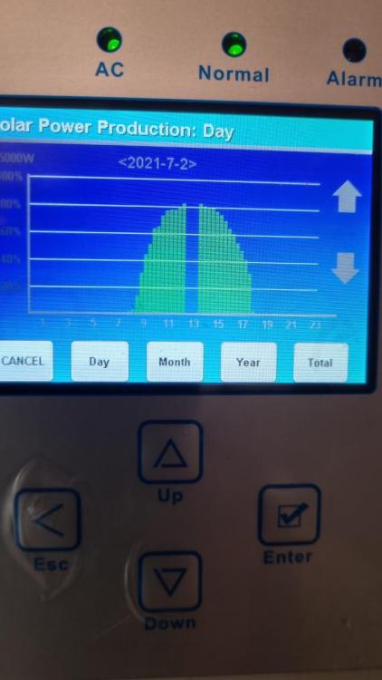

I noticed on the 2nd of July that the 'time of use' function did not switch the load from the grid to the batteries.  I checked the settings but everything appeared normal, no alarms were recorded.  During the day I also noticed that the production graph on the screen displayed a break in production as well as an increase in grid usage for a period of about 2 hours.  The same happened on the 3rd of July and again today.  However, the break in production -inverter not functional - lasted longer on the 4th of July. (3.5 hours).  I noticed that the clock advanced to a different time zone, even though I disabled DTS in the settings of my account.

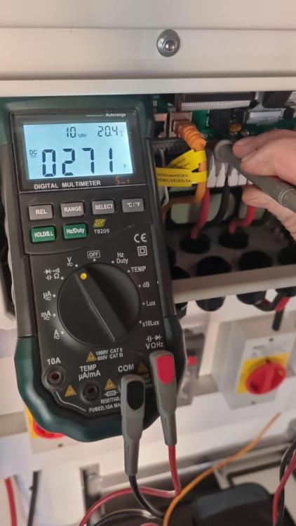

I inspected every variable I can think of, checked every connection, measured PV voltages and loads, took temperatures but everything seems to be normal.  The Deye shows DC, AC, Normal and No alarms.

The issue with the production and consumption graphs also seem to be resolved now. Since this programming change, the graphs don't display the break in production/consumption values anymore.
