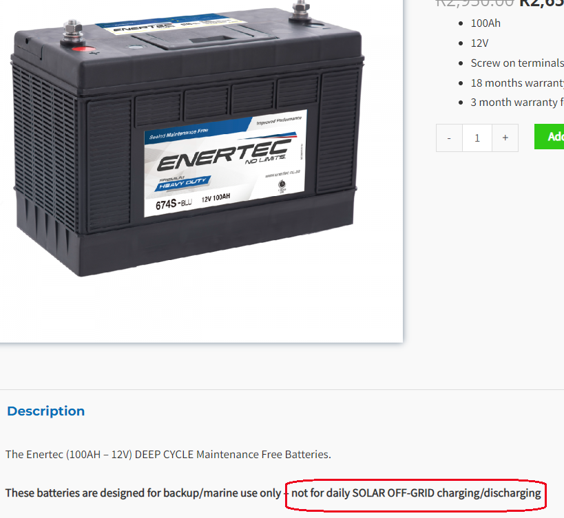

I note that Enertec make both Lithium and lead acid 100 Ah batteries. If it's the lead acid, note this warning from the first Google hit:
I wonder if they had to put up this warning after finding many customers complaining about short life in their solar energy systems. I guess they're designed for occasional deep discharges, not regular shallow ones. Though of course, many users are tempted to use them for regular deep discharges, and they don't last long with that usage.
