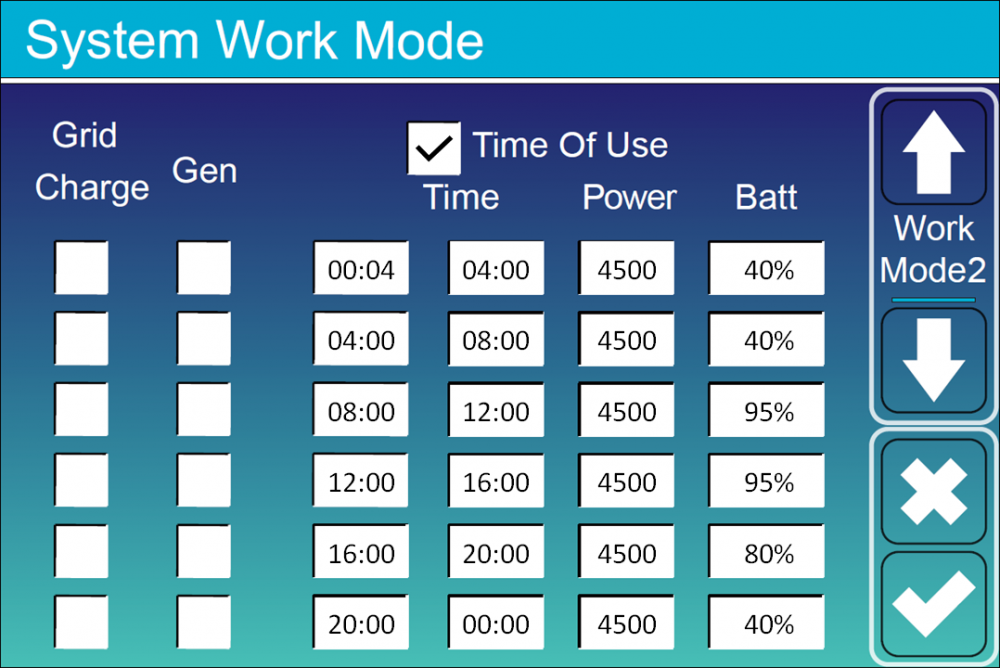

On 2022/03/03 at 4:57 PM, MdF said:
Hi KBS,
Below is what I currently have running on my 5kw Deye:
(1) From 12pm midnight to 4am the battery will power the house and potentially run down to a SoC of 40%.
(2) From 4am to 8am the same as 1 above but with the sun coming up, PV will start to run the house and charge the batteries.
(3) From 8am to 12pm solar is running the house and fully charging the batteries up to a SoC of 95% in preparedness for the coming evening.
(4) From 12pm to 4pm, what's left of solar runs the house and trickles in to the batteries charging the batteries up to a SoC of 95% in preparedness for the coming evening.
(5) From 4pm to 8pm the batteries start to discharge but this is over dinner time when there is quite a draw on the system so I only go down to a SoC of 80% (I'm still figuring out what the best SoC will be for this Time of Use as I am sure I can get to 75% and still have enough in case there is evening loadshedding).
Hope this will help you. Otherwise there may be a fault on your inverter and its not "saving" your changes.
MdF

Post a picture of your timer settings. It might help to answer as settings will be the key.
