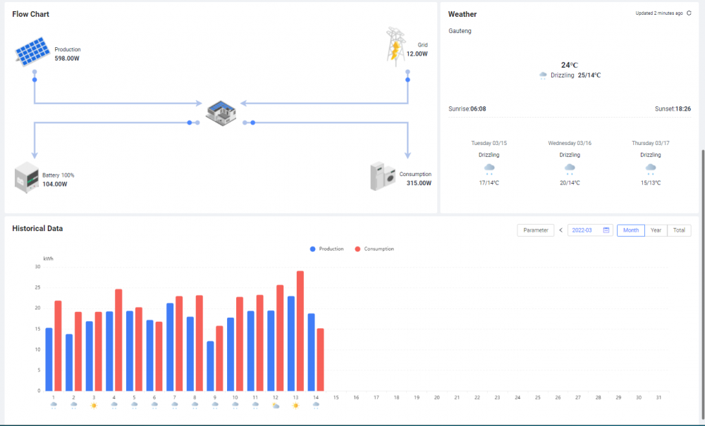

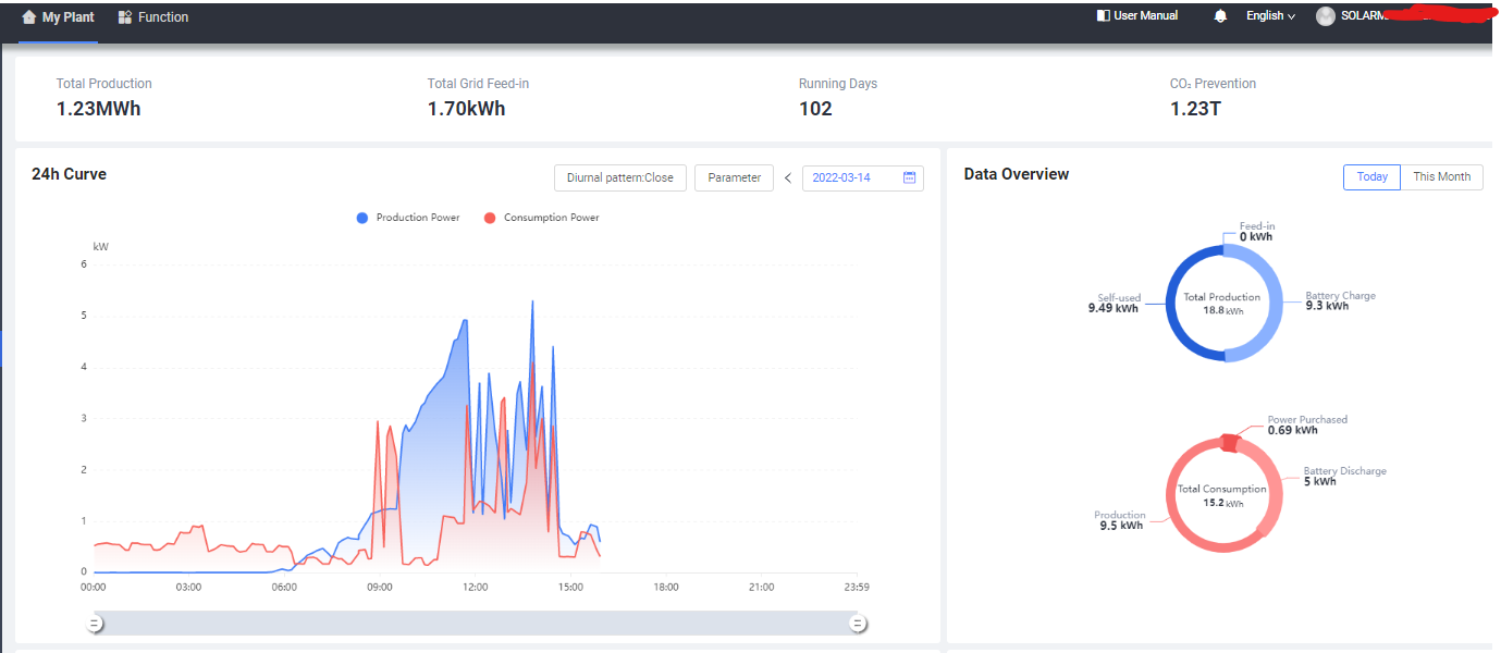

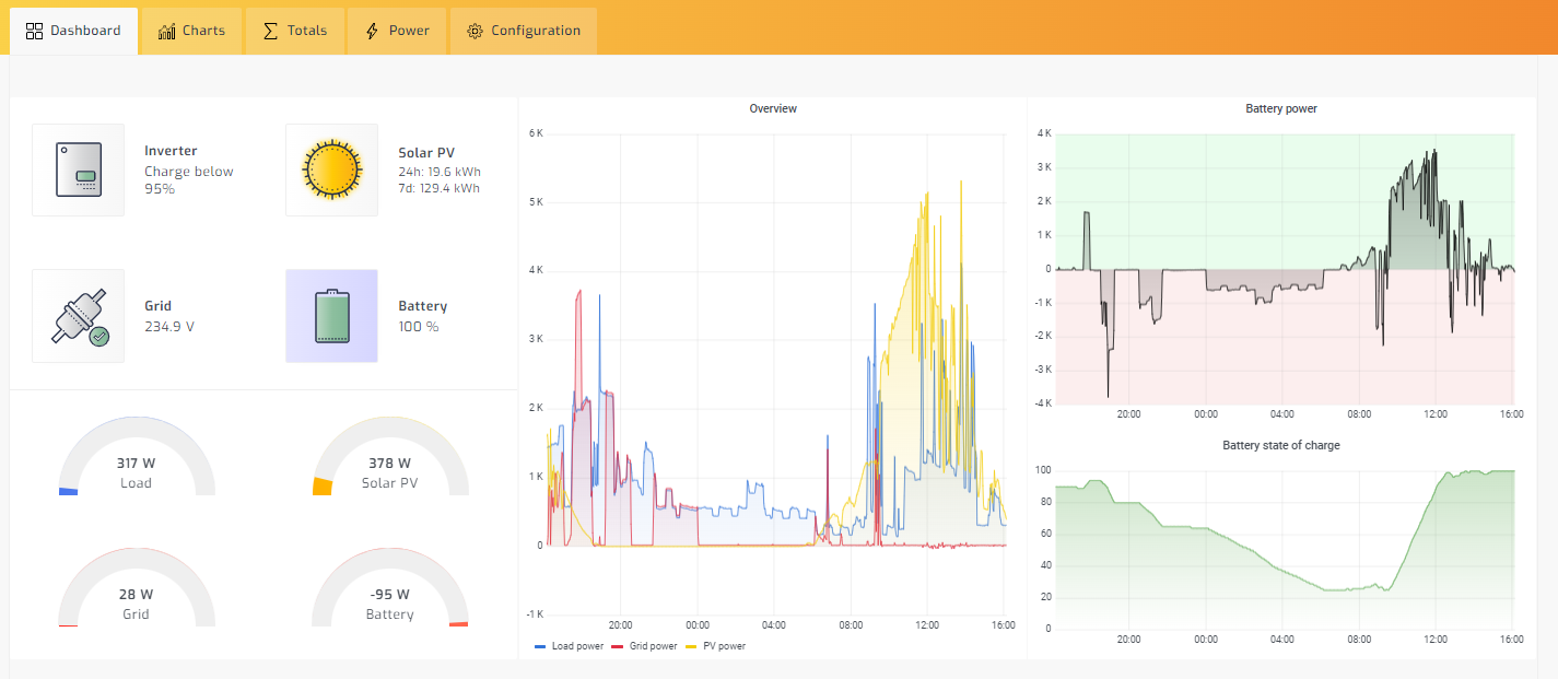

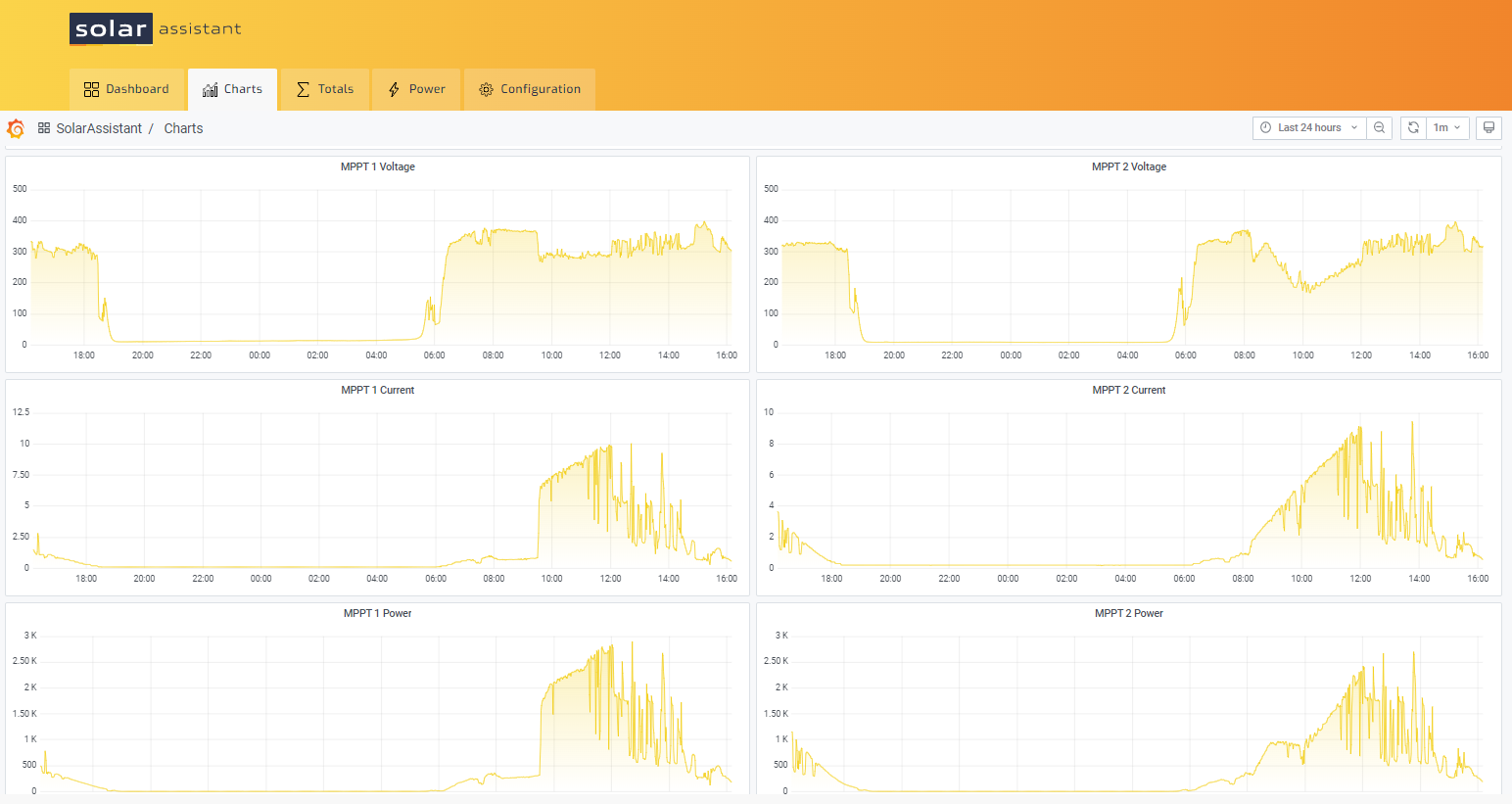

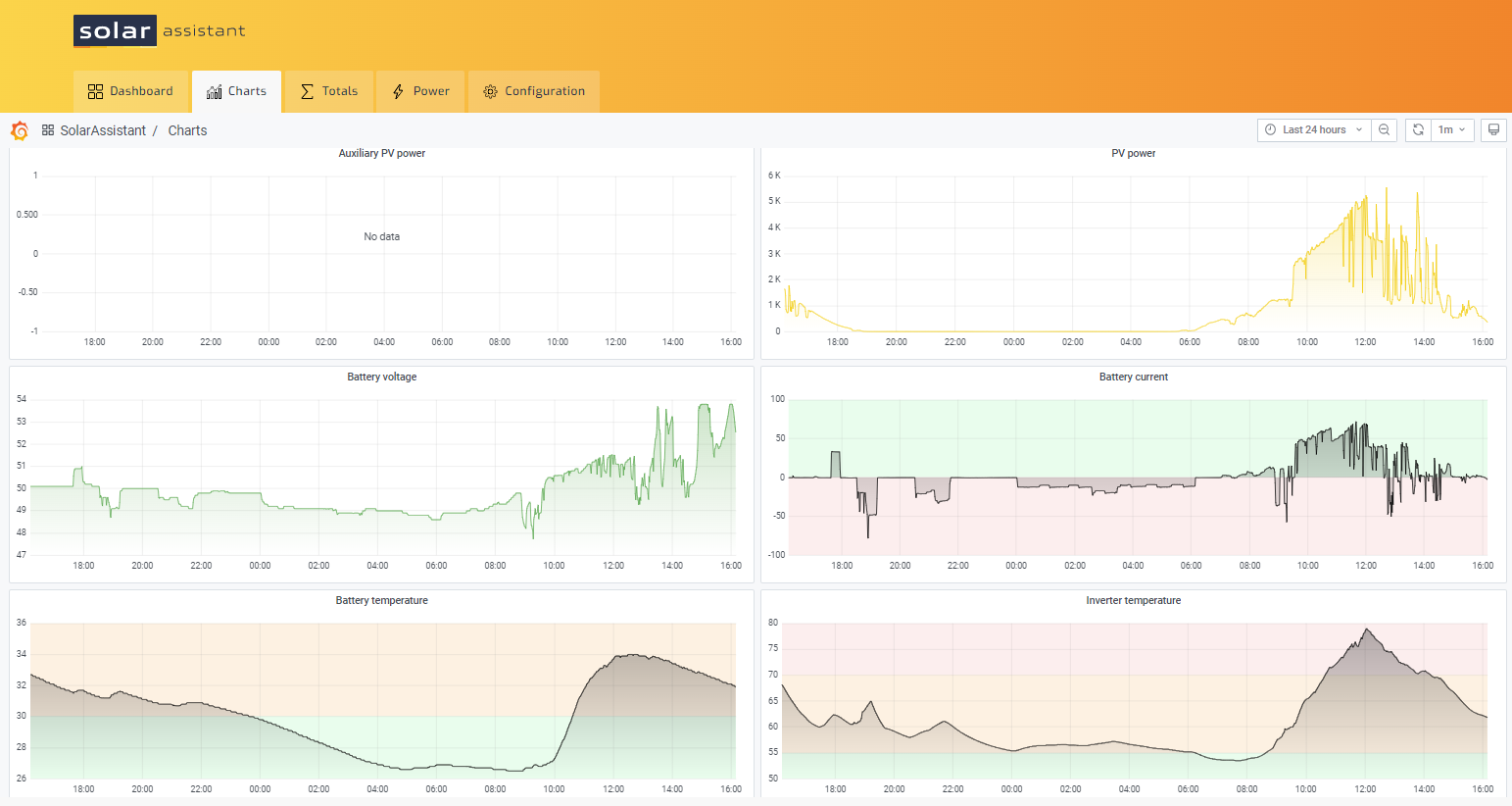

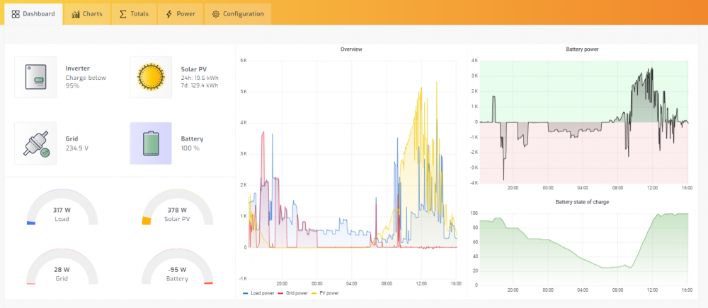

Yup - 5kw should be enough. Correct on the additional batteries - i recently added a second 4.8 (9.6 in total) and can now pull just under 4.8 from the batteries
Also happy to share any charts / experience with you - even a site visit (in PTA)
Thanks, and charts you can share will be great. Been having a look at some of the charts on the forum as well
