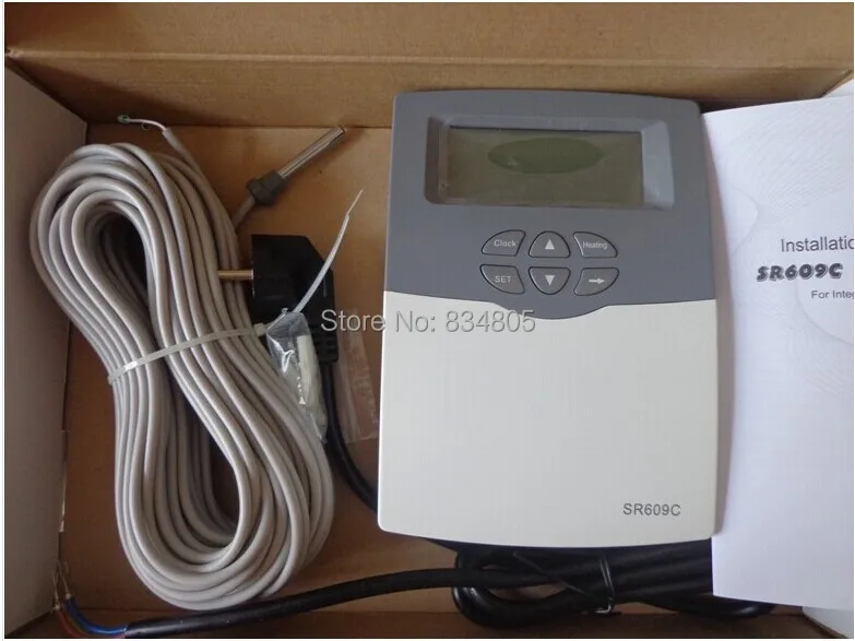

don't buy SR609C geyser controllers
Ok, so quite a few companies stock this geyser controller and it's being installed by many solar geyser installers as well. It's slightly cheaper than a geyserwise controller. sustainable and thesunpays are two common names in the industry who stock them. Rather get a geyserwise unit.
I would not advise anyone to ever buy a SR609 / SR609C geyser controller. Why?
- It's not SABS approved so you will probably have trouble replacing it through insurance. Your insurance may probably also deny your burst geyser payout.
- It plugs into a wall socket, and then have another power cable into the roof to the geyser. This might be fine for some people, but IMO a geyser should be permanently wired in such a way that un-informed people can't turn it off or fiddle with it.
- The above point also mean, that if your insurace were to send out a plumber to fix a burst geyser, while you're on holiday (and your neighbor / family member / friend) watches the house, the plumbers might reject the job if there's no isolator in the roof - or worse, redo the wiring to be of correct standards. And then you might have to redo it when you get back. SO, one way around this issue is to run a power cable from the isolator in the roof to the geyser controller, and another one back to the geyser again.
- it doesn't have a proper safe connection for geyser elements with push in terminals - commonly used on Kwikot, Franke, etc. i.e a "screw in" type element has two screw rerminals where you can connect the wires to. With these elements you connect the electrical wiring to the thermostat, which then push into the pocket and connect to the push-in terminals. You have to remove the thermostat to insert the SR609 thermostat, thus exposing the push-in terminals.
- The menu options on the screen are not that easy to understand or use. It's fine if you're a geek, but your mom and uncle will battle using it.
- You can't activate the geyser element on demand. So, let's say your scheduled time-on is at 15:00 but you want to shower at 10:00am, you can't just active element at 8:00am. You need to set the timer to activate at 8:00am. There are three timers, so if you already have those set, you would have to change one of the timer's time settings to 8:00am.
Geyserwise VS SR609C:
- Connecting the geyserwise to your geyser is much simpler. There's a small cable that goes down the wall, to the display unit. The rest of the equipment stays in the roof and get installed right next to the isolator. This makes a 3rd party plumber's work also much easier.
- The geyserwise unit replace the existing thermostat with another one, built by Geyserwise for this purpose. i.e. it won't void your COC
- The geyserwise unit is SABS approved and insurance don't have a problem with them
- The geysewise unit allow you to activate they geyser element with a push of a button, instantly.
- Lastly, the geyserwise menu options aren't Chinglish - you can actually understand it without consulting google or youtube.

The SR609C cost R1095 @ thesunpays.co.za and a geysewise cost about R1200 from various websites. So the R115 saving won't even afford a contactor, which can cost anything between R200 and R800!

There are a few variants of the SR609C, which one do you have? The ones I got from thesunpay look like this, but with a "M.H" button, instead of "Heating".
SR609C-Solar-Water-Heater-Controller-for
